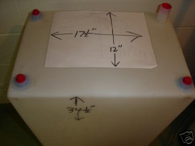

    I would mount it either in my washroom that links to my garage or in the garage itself. From there - I would need to come up with a tank solution large enough to hold enough rinse water for several vehicles at once. I think that an 30 gallon RV style tank mounted near the garage door would be perfect. I would mount some type of ball valve and and float setup to regulate the water flow into the tank. Not sure on exactly how the valve would work but I'm figuring it should be fairly basic and easy to figure it out. Tanks can be had for $50-$100 shipped. Going with an RV style tank vs a large drum would enable it to fit behind the garage door track and not take up as much room in the garage.
    I would also want to mount it high enough so that I got enough head pressure to not require a pump when I connect a hose to the tank. For everyone that has ever used a spot free rinse setting you know that it's a very low powered/low volume spray as not much is required to do a solid final rinse. Since I've got motorcycles, off road machines, a truck, and of course my S4, I spend way too much time cleaning and detailing vehicles. I see this as a way to speed up things a bit by not having to be so incredibly fastidious on my drying as well as produce over all better results.
