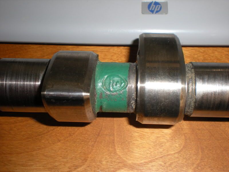

    Need help identifying cams
    http://minneapolis.craigslist.org/ws...889231391.html
    And he gave me these pictures. These are the only markings.

    Found a little bit of help. Autotech maybe? http://forums.fourtitude.com/showthr...dentification)

    They are not stock cams. All 1.8t stock cams are the same as far as I know.

    If you look at IE cams, it looks like the same logo but not a clear shot:
    http://www.ecstuning.com/ES2794022/?...ZlcaAuDG8P8HAQ
    IE cams look like they have id's printed on the end.

    Yeah they aren't IE's. Seller said nothing on the end.
    If you look at that Fortitude thread I posted along with the pic, that symbol is for Etsas, a company that makes cam blanks. So, they are aftermarket but I would still like to know the specs before I would buy them. I offered the seller $100 no questions asked but it was not accepted

    buy em, then ask me nicely and I will toss them on the cam doctor.

    no gamble, no win. pick up a cheap vernier caliper and snag a couple measurements off of them, I'll check a known stock cam I have laying around.

    I have both a caliper (mitutoyo even!) and a set of stock cams. I'm leaving tomorrow morning for St. Cloud to shadow an attorney and do the valentines day thing. If they are around Sunday, I will probably snag them. Gotta go up to Forest Lake though. May have to stop at Running Aces lol

    Autotech does not make an exhaust camshaft for the 1.8t. Honestly, I wouldn't even bother. You have no specs on them (and neither does the seller apparently). Is $100/$200 worth the risk of possibly getting improperly timed camshafts? You have no idea what max lift is, what lift at TDC is, duration, etc. Or you end up paying $100/$200 for stock camshafts? Has the seller actually ran them in a motor? They look untouched.

    If he goes to look at them and can determine with a couple quick measurements that they are or are not stock I already told him I would toss them in the cam doctor and we will know exactly what they are.

    Pretty bad when a seller can't even tell you what brand part they are trying to sell. I guess this is bound to happen with all the salvage yard pickers out there now.

    the seller is a shop. they took them out of a customers car because they wanted stock cams back. the cams were sitting around for a couple years they said and are just selling them now. I might grab measurement

    Could also ask them to send you pictures of the gears on the back, that might help you figure out what brand they are.
