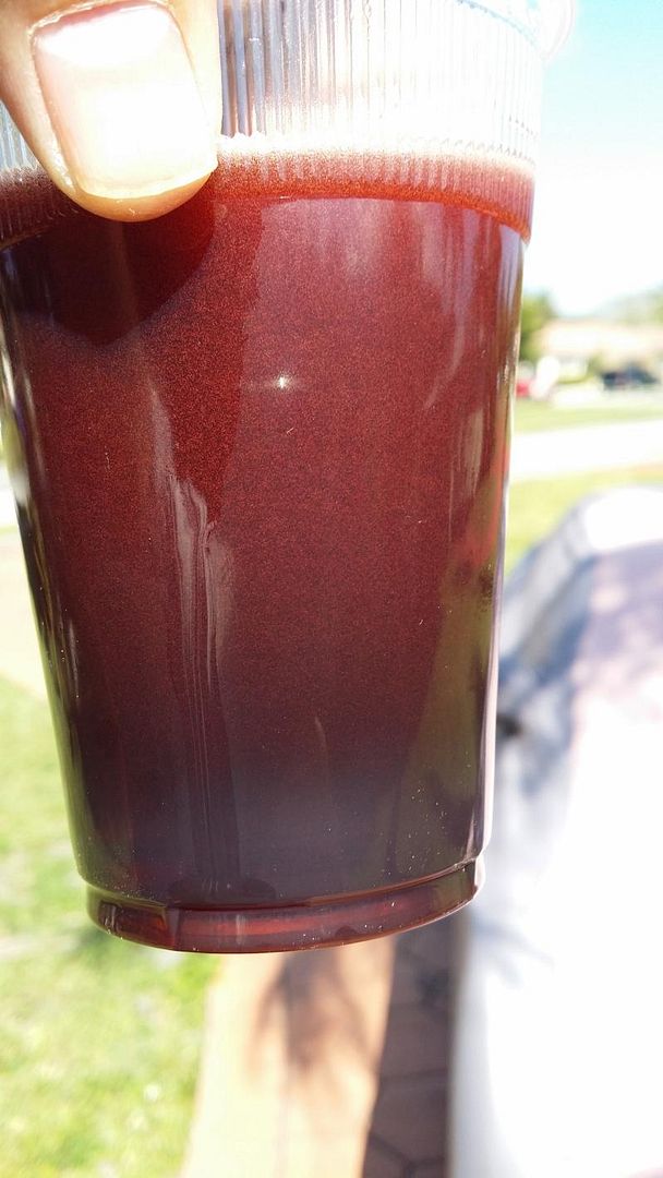

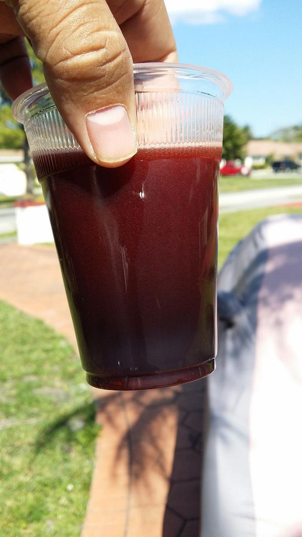

    Thanks for the write up....I followed it and this is what I got.
    I pulled as much fluid as I could with the turkey baster and then disconnected the hoses and a good amount more came out. I cleaned the resevoir out with brake cleaner and cleaned the screen as mugh as I could.
    There was no plastic within the resevoir and not sure what may have happened. If you look at the fluid I drained it was reddish in color and somewhat thicker than fresh fluid. I pulled old fluid before where it was a creamy brown color but this was new to me. Last time I swapped fluid out was 2 years ago and replaced with the green chf.
    The plastic piece was Brittlle and red. Is there a chance it melted and fudged up the fluid???. I added a new can of chf and drove around for about 2 miles and things have dramatically improved. I still have some fluid left and thi k I will swap out what I can to see if it gets better.
    My Q is do you thi k the plastic piece melted?

    Looks like a beet smoothie ha ha....my guess is the plastic melted and infused into the fluid.

    Quote Originally Posted by mgikone69 View Post
    Lotta heat, pressure, and possibly gas introduced to the fluid as well. The doom of all hydrolics.
    I'm glad it is at least better!
    That is an interesting question. I would think the systems would exceed boiling point of water, so there is a chance. If nothing came out then maybe that is the only option. A full flush as per the DIY may be required. I have never done this personally - I just emptied the reservoir after 3 or 4 drives with a turkey baster and refilled with new fluid each time.
    Yes and what fluid is that? The OEM stuff is green and I've read in many places that you really should deviate from OEM. But I've also read in other places the opposite.
    If it's better I'd leave it now. Good job though!
    As an aside were there any micro fragments in your filter? I found heaps when I did mine. Shining a light through the filter revealed heaps.

    I didn't shine a light to it but I sprayed the hell out of it with brake cleaner. It visually didn't look clogged.
    I always used chf on this car. Last time I flushed it I assume it was the original fluid at 69k and it was brown n milky....iI swapped it with chf which is green. When I checked the fluid yesterday it was still green but more towards black green than the original clear green...oonly thing was it was a lil low. That's where the problem happened with me dropping the plastic in there.
