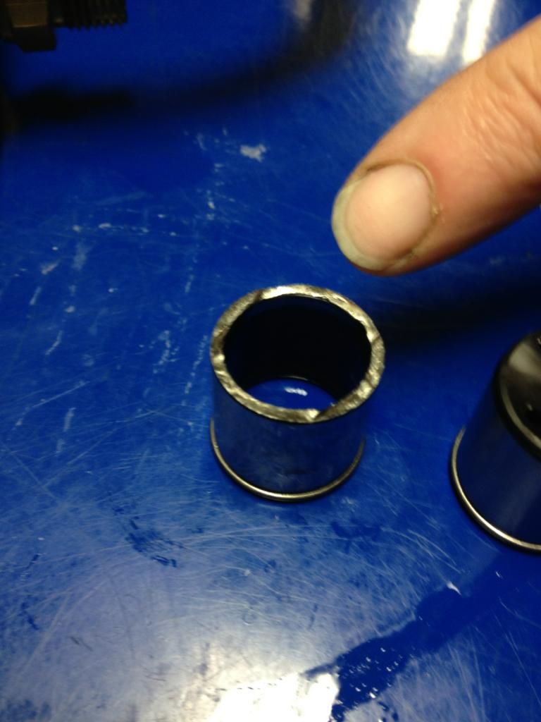

    Cam Follower Failed. Need advice talking to Audi
    Hello. I purchased an 08 a4 with 54k back in October from an audi dealership. It was not a CPO and I did not get an extended warranty. In barely 4 months of ownership, I've had the TPMS antenna fail, my thermostat/coolant temp sensor throw codes (needs to be replaced) and the most catastrophic... my cam follower failed. The dealership I bought it from said they can't do anything since it's out of warranty and my VIN doesn't show any recalls.
    I had another dealership do the diagnostic work and they confirmed the cam follower failure and are willing to cover 50% of the service cost. I would still have to pay $2425+tax. Although this is better than nothing, I'd like to escalate this up to Audi Corporate. This issue is incredibly common (recalls 05-07) with these cars and how did the dealership I bought it from NOT see this? My cam follower had a hole in it the size of a nickle.
    I come here asking advice on how to get further coverage from Audi. I've already contacted Audi HQ and put in a request to look into this further. I know i'm probably shit out of luck since there is no warranty, it's not a CPO and there's no recalls but is there anything else I can do?
    I know this is a common issue and I've read a lot on here about people's experiences. Any advice would be MASSIVELY appreciated.

    So, having gone through this EXACT thing, with my 2008 at EXACTLY the same mileage (crazy, but mine failed around 54k as well) my advice is this:
    1) If you feel comfortable opening up your engine and replacing the cam, do it yourself. Its a shitty job but you can get the parts for it for around $500.
    2) If you aren't That deal the dealer is quoting you is decent. My local dealer quoted me $2000 for the same repair.
    3) Expect Audi Corporate to be completely useless and stick to the script of "sir your 2008 model isn't covered because it was built with the "fixed/upgraded" parts from the factory." Its complete bullshit, but I tried multiple times to explain this to them but they were completely unhelpful and verging on rude with their rebuttals.

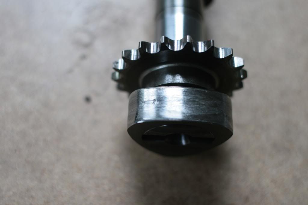

    For reference, this is my cam, follower and pump at roughly 54k on a fully stock car:
    I ended up doing the work myself, with the help of a friend or two. The job sucked, but I added on a full Timing belt service (while I was in there) and still saved $1100 over having the dealer do the work.
    -CP

    Yea Its hard to know. I think my failure was due to oil starvation (no real evidence, but its a working theory) as I also have an oil consumption issue. The previous owner I don't think was super nice to my car unfortunately. The oil consumption could be due to bad piston rings, or bad turbo seals, not really sure which yet.
    Either way, running Shell Rotella T6 since I replaced the Cam at 54k miles, my car is not around 70k miles and last time I inspected the follower the wear looked minimal and the cam surface was perfect.
    I honestly think some of the 08 BWT engines had some assembly issues causing these sorts of REALLY early failures. My old 06 had very minimal cam follower wear at 80k miles, and that was with the original revision cams...
