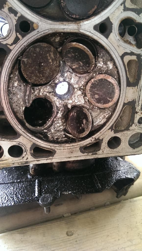

    Somethings off...
    Now I know why the car came to me on a flat bed..

    Hate it when that happens
    Driver side like usual?

    Quote Originally Posted by jballou View Post
    Yeah drivers side.
    Thing looks clean in there like they take care of it oil-wise.
    Does it see a lot of high rpm action?

    retainer give out?
    Veteran Member Four Rings zillarob's Avatar
    Nov 16 2010
    67118
    2kS4, 84gli, 84caddy dsl
    WetSide, WA

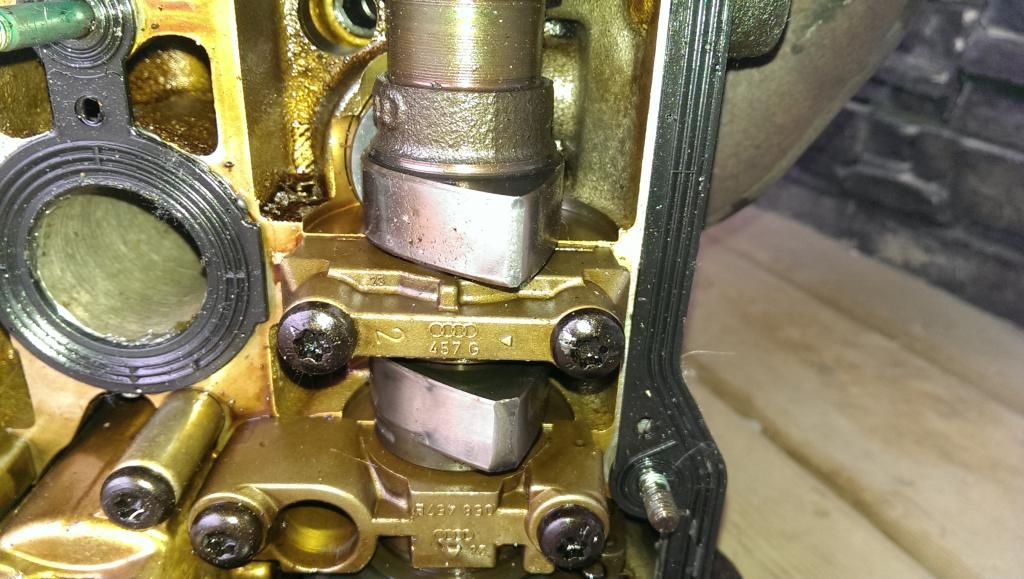

    Cam went flat and chewed through the lifter. Very common on the driver side.

    Why is this common?
    I had the same issue on the same side on mine too cupple years ago.

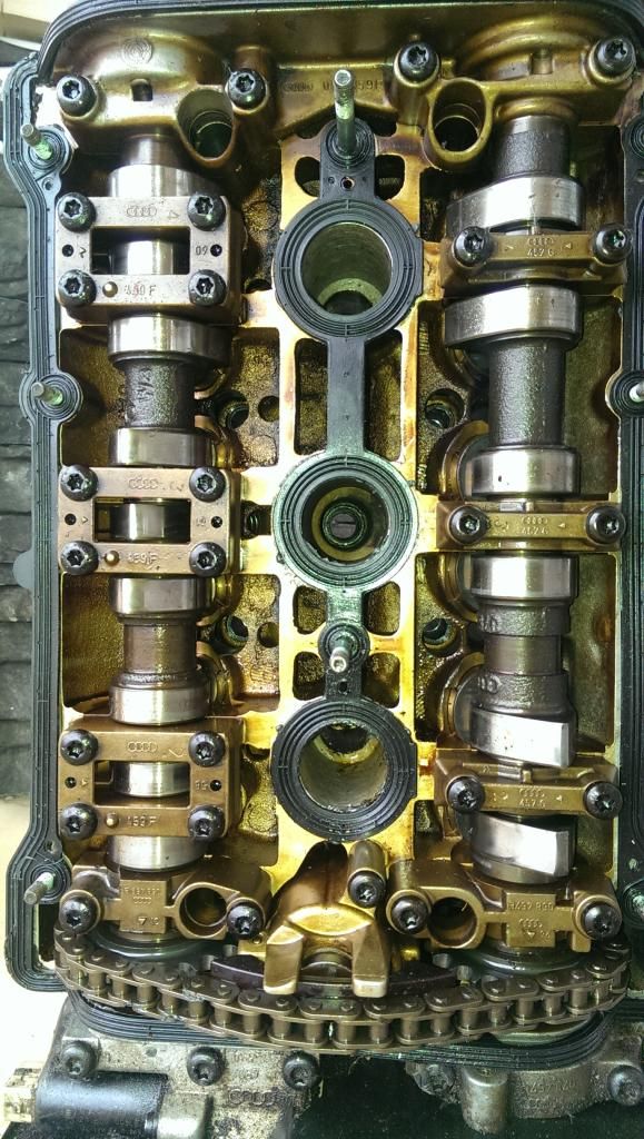

    Not sure anybody really knows for sure. Junk oil or running it to long could be a cause.
    My best guess as to why it is always the dside is the oiling system and the direction the cams rotate.
    There is a pretty good pic of the 2.7 oiling system in the ssp.
    It shows the pside head fed directly from the main oil galley, but the dside head is fed from one of the crank mains.
    The heads sit at an angle with oil flowing down from the center over the lifter.
    The cams spin cw when looking at the front of the motor.
    The pside cam is rotating the direction that the oil is flowing and basically drags the oil through the contact area. This is good.
    The dside cam rotates opposing to the oil flow and is pretty much always trying to push it away from the contact area. This seems to be not so good.

    Theres not much you can do to fix this, i also noticed that its almost always driver side head.
    Jul 16 2012
    96927
    Caught a few 1.8T motors close to this with obvious wear. Sure in this case the 2.7 oiling plays a role, however high ZDDP oil needs to be run or flat tapper motors do this and flatten cams out fast

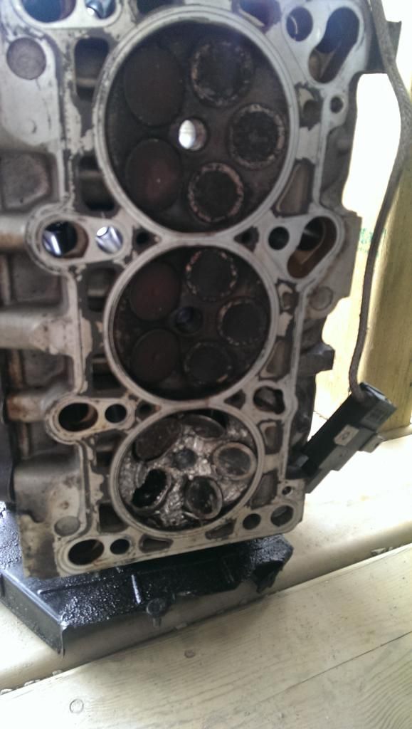

    cam lobes on exhaust cam cyl 4 went flat on mine and dishes both lifters causing cyl 4 to grenade and put a hole in the piston. that day was shitty.

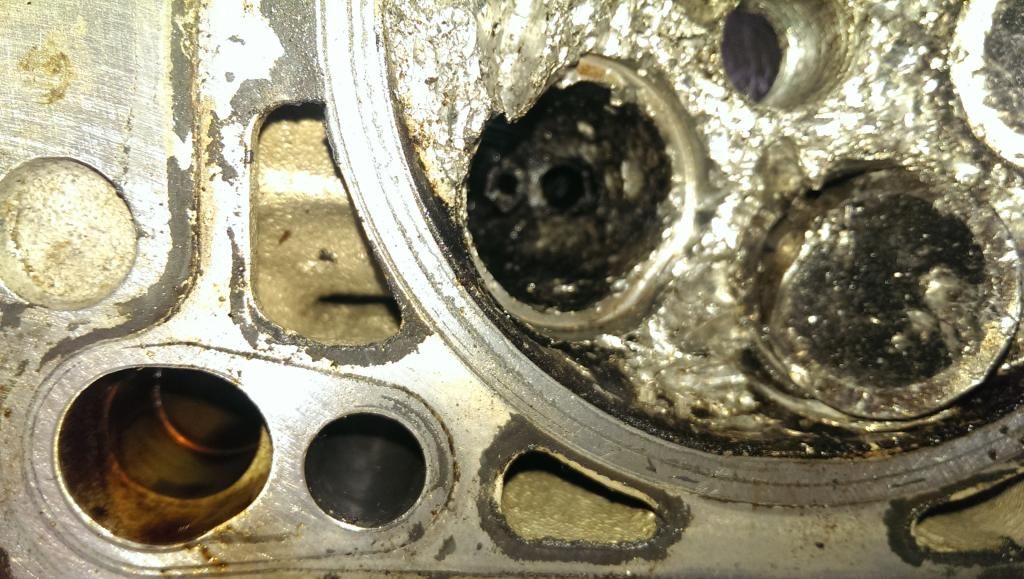

    Meh, that shitll buff out
    Hes lucky it didnt knock the valve locks out and do the same as morris.
    Looks like that job just got expensive though

    So, the lesson of the day. If you have loud ticking noise, address it immediately. I knew what it was when the customer showed it to me. I told him to stop driving the car. He did after the car wouldn't run anymore.
