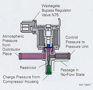

    Ok,
    I'm going to ignore the last half with the driveability concern and just focus on getting the n75 plumbed properly.
    Your n75 should have a long port, and a two short ports.
    The long one is for the ambient air(in the turbo inlet pipe). The one OPPOSITE of the long one is the Wastegate actuator. The one pointing perpendicular is the turbo pressure(on the turbo housing).
    Here's a diagram.
    For parallel, you just use two T's and run the mbc per the manufacturers instructions, just to the T's for the respective spot.
    Here's a diagram for that.
    I would try just the n75 first to remove as many failure points as possible, then go from there.
    Do this, and see how the boost acts.
