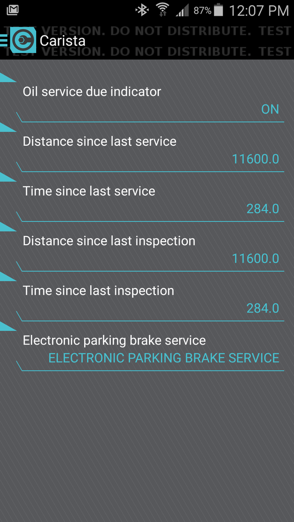

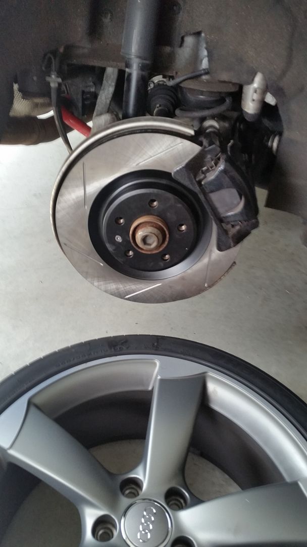

    Huge shout out for Todor and Carista's customer service! I've been tearing up rotors and pads on the track and it was time to replace the rear pads and rotors.
    I have the Pro version and the Carista dongle. Last night around midnight sent an email to get included in beta testing so that I could try out the Parking Brake release. Got up this morning (Saturday!) with an email from Todor and I was good to go for trial purchases.
    What I thought was an intimidating job was easy. Ignition on, motor off. Connect the app to the dongle and release the parking brake. Turn off the radio and anything else off so you can hear the motor unwinding for service position.
    Wheel off, loosen the two 13mm bolts behind the caliper part that holds the pads. Leave the outer caliper bracket on. Pads should slide out of the clips easily. I also loosened the T30 star screw to swap out the rotors. Rotors came off fine without having to remove the larger caliper bracket.
    Then you'll need a piston pusher tool like as seen below. I found mine at O'riellys for $9. Worked great to ease the piston back. You'll need to push it all the way back in if you have new pads for clearance.
    Tip 1 - to get the caliper back in with new pads inserted, I needed just a little more slack in my brake line. There's a release of a rubber grommet on the brake line that secures it that gives you this extra length to get the caliper back over the rotor. Remember to reattach it!
    Tip 2 - my Audi tech also suggested that I check the wheel speed sensor for any metal shavings that it's designed to pick up. It's found at the 4 o'clock position on the left rear wheel, behind the rotor and opposite for the other side. The wire unclips with a small flathead and then unscrew it with a 5mm Allen wrench. There's a magnetic pin that will slide out and you'll see some shavings that it caught. Wipe those off on a paper towel and reinsert and reattach the wire.
    Reassemble it all, using some Locktite on the 13mm bolts. Then back to the app for Parking Brake closure. Worked great!
    Only beta feedback I have is that I'd rather not pay $10 every time I have to do this once it's in full release. As I track often and swap out pads as needed. That pay-per-use might suck if it's the business model. For now it's exactly what I needed. Thanks again Carista!
