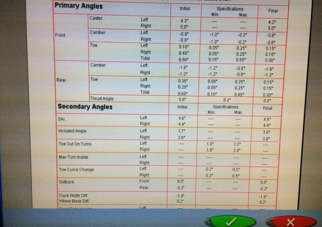

    Toe and camber were within spec, however the caster is off. The caster's left side is 4.2, while the right side is 5.0
    I can feel the car steers slightly more to the right if I center the steering wheel. Took it to a local suspension shop, everything was checked and nothing was bent or broken. Tie rod, lower control arm and sub-frame were all good.

    Just a regular local shop I usually go to for my alignments. Nothing fancy but will get the job done right.
    Here is the result:
