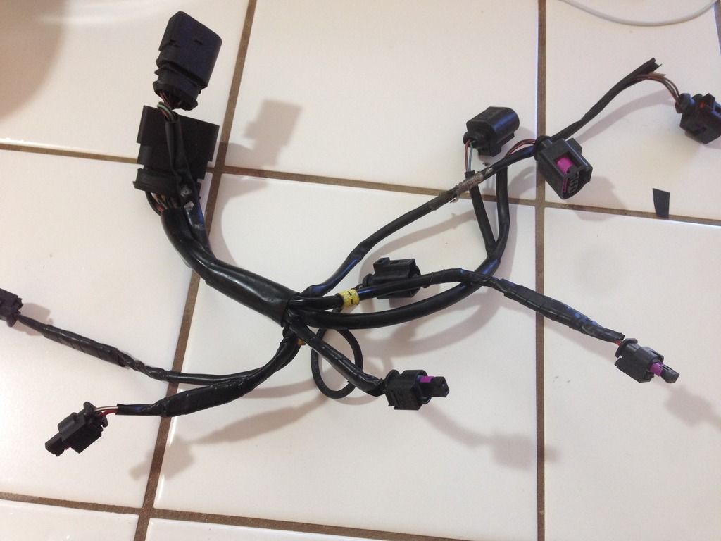

  2. #162
    Veteran Member Four Rings ericpaulyoung's Avatar
    Feb 24 2011
    71439
    '08 a4 b7 6MT
    Eugene / OR
    The finished harness

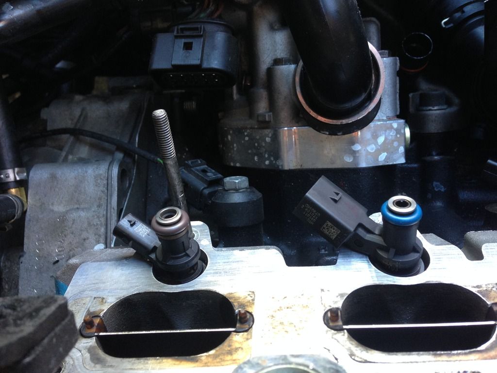

  6. #166
    Feb 24 2011
    71439
    '08 a4 b7 6MT
    Eugene / OR
    They fit great. They sit a little lower than the old RS4 (old on RS4 on the right and new RS4 on the left).
