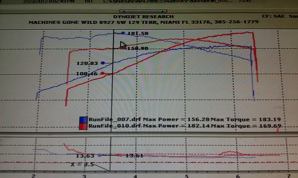

    Yeah, it sucks that it costs that much. However from what I see, the intake manifold changeover working properly adds about as much (or more) power than a reflash. Maybe you can source a used one?

    ...from what I see, the intake manifold changeover working properly adds about as much (or more) power than a reflash.
    That does make it much more convincing. I've been casually hunting for a used one for a while now and they never pop up for a reasonable price. Buying used seems kinda sketchy too since they're so prone to breaking already. I think I may end up just getting a new one in a couple weeks when it's the last thing I need to do.

    Here's a dyno with the manifold changeover stuck in long/short positions respectively. If I had to choose, I'd leave it in short runner mode. However, you loose a ton of torque below 3000 RPM.

    Hey all, I added another file revision with more aggressive cam phasing (dropping off all the way to 6800 RPM. Feel free to check it out

    First, I would say that you could very likely use the first version of my tune with the stock cats in place. I only included that warning to cover my ass in case someone did use it and found that it caused issues.
    I've been using a similar cam control strategy on my B6 S4 (with the stock cats) and it's worked quite well.
    With respect to the time that I had to put into it, bear in mind that I started from scratch, with no clue whatsoever how to tune ME7, no DAMOS for the V6 (or any DAMOS for that matter) and no existing tuned files to reference.
    Now that I have 6 gigs worth of definition files, a working DAMOS for my engine, reference tuning files for N/A engines and half a clue as to what I'm doing (lol), I can pound out a tune in 6-8 hours. I did it for my folks V8 Tourareg in fact.
    Really, it's not that hard. In a very general sense, this is what you do
    -Add values to the last 5-6 rows of KFMIRL,
    -rescale the KFMOIP axis accordingly (to match the new KFMIRL values) and possibly add some values to the last row of KFMOIP, -
    -look at the timing tables, smooth out any dips from the factory. If possible, add 2-3 degrees globally depending on fuel quality and elevation
    -redo the KFPED throttle tables to suit. (you can always look at tables from other, sportier versions of an engine and import them as a baseline if you don't start from scratch)
    -modify the cam timing maps to give more advance and then drop it as if you were roughly following the engine's volumetric efficiency)
    -some other maps that you may want to look at are the smaller 8x8 maps of torque values in the command list as well, but I haven't messed with them yet.
    I would submit that what drives the secrecy is the fact that once you have a few good reference files, it's not that hard to import those values to other platforms. I think that if people really knew how little R&D some of these tuners put into these products, that they wouldn't be willing to pony up $500+ for a canned tune.
    Now, in fairness, there are some companies who legitimately put a lot of R&D into a product. However I would say that these types of products are ones that interface with the vehicle and require actual programming code to be written (like the REVO SPS cables or the APR switching software). Also, products which allow for OBD flashing of the more recent ECU types are also difficult to produce. I can understand the cost and secrecy associated with these types of products.
    What I don't agree with is the secrecy associated with letting consumers know in a general sense, which map areas were re-calibrated. Really, it doesn't put the tuner at a disadvantage if they tell someone that, say, they re-calibrated the cam control. Just because I know they re-calibrated a map area, it doesn't give me any idea as to how they did it. However, it gives a sense of just how much work was really put into the tune.

    Also, I think I may have an idea for a bit of a different approach to building the remainder of my exhaust system.
    I think I'm going to see about incorporating some venturi transitions into my exhaust. Basically, what I think I'll do is use a pair of shallow transition (9 degree angle) cones to increase the exhaust velocity before going into the crossover pipe.
    It's not going to be a massive neck down, just going from 2.5 inches to 2.25 inches. It's partially driven by cost considerations as I have a bunch of 2.25 in mandrel bends kicking around.
    However my theory is that while the neck down will decrease high end flow slightly, increasing the exhaust velocity before the X pipe will aid in mid range torque production.
    Basically, it's a bit of a trade off. However, since the stock enand maximize those gains rather than try and maximize top end power. Put otherwise, best to base your power adders around your engine's best volumetric efficiency areas in the powerband.
    Thoughts from the peanut gallery?
