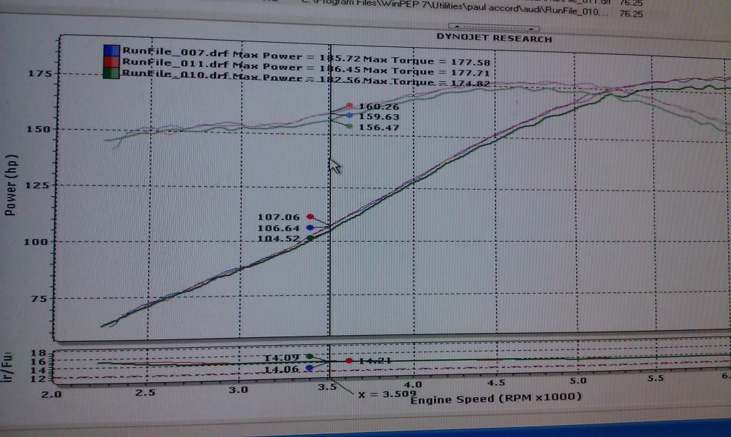

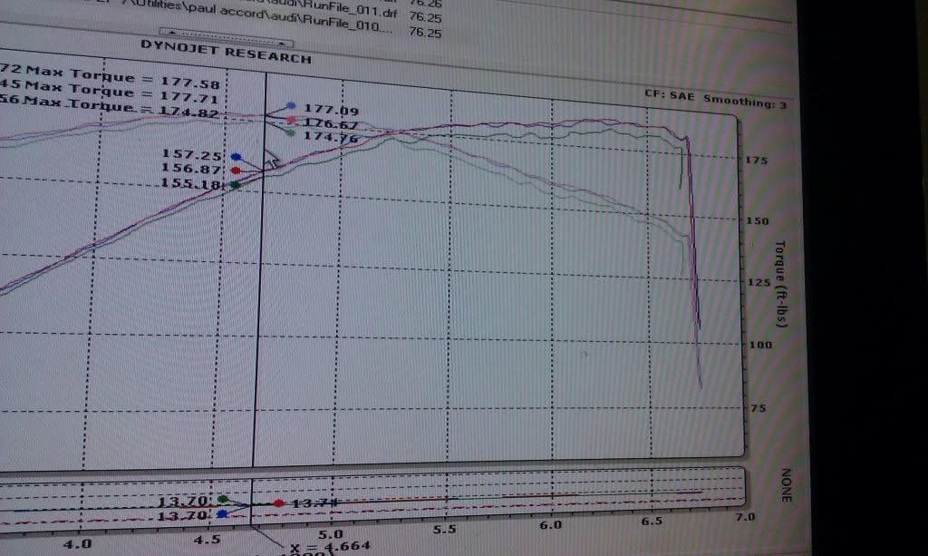

You explain to me how my setup is a hot air intake when there is a 3 mm thick metal barrier, with DEI thermal reflective material between the filter and the engine, along with the stock snorkel which is blowing outside air into the partitioned air filter area...
It kinda boggles my mind how so many people here blindly buy into the notion that the stock airbox simply cannot be improved on.
1) If you actually look at the stock intake snorkel location, it's not at the leading edge of the hood. In fact, it's about 4-5 inches back and draws air that has to pass though a heat exchanger first (the A/C rad IIRC). So you're actually getting turbulent air (b/c it's blocked by the rad) which has picked up radiated heat as it passes through the A/C radiator assembly.
2) the incoming air into the stock airbox has to make a sharp 90 deg bend to get into the airbox, then make another 90 deg bend before passing through the panel air filter into the intake tube.
3) there are 2 sections of accordion type tubing (which does not make for smooth laminar flow) in the stock airbox. the first being in the intake snorkel and the second just after the MAF sensor.
Now can someone explain to me how that is somehow more efficient than drawing through a cone filter in a partitioned area being fed by the same snorkel that supplies the stock airbox, which then passes into an internally smooth 90 degree radius bend and then takes a straight shot into the engine through the same diameter, smooth walled silicone tubing (which BTW, is thicker and more heat resistant than the thin walled plastic accordion tubing which is used in the stock intake system?).
I'm sorry, but when I look at the facts laid out here, there is no logical reason for me to believe that the stock airbox flows better than what I have made....
