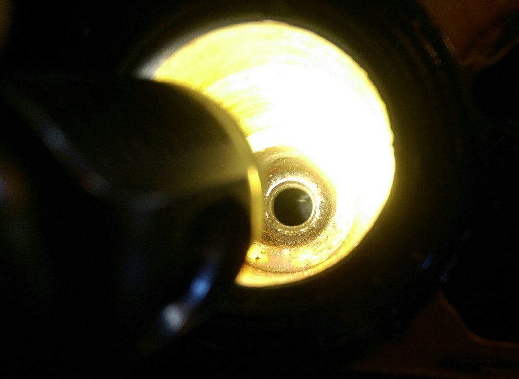

    I can see evidence of valve smackage on all four pistons...
