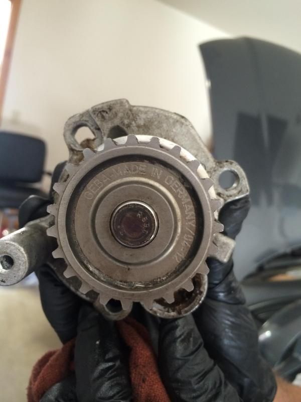

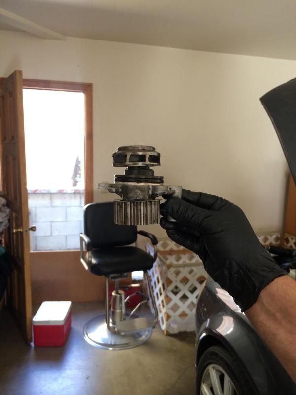

    Quote Originally Posted by redline380 View Post
    Its most likely only valve damage, yes, but it just so happens brand new short blocks are on special from Audi right now for $606.73, complete with new pistons.
    http://genuineaudiparts.com/parts/in...&siteid=214407
    At that price, it is worth doing a short block prophylactically, and a rebuilt head. That will essentially be a new engine for cheap.
    BTW OP, the coolant pump runs with permanently greased/lubed ball bearings, the seized pump is due to failed bearings, it has nothing to do with the coolant itself.

    Quote Originally Posted by diagnosticator View Post
    agree with this
    my metal pump looked exactly like yours op

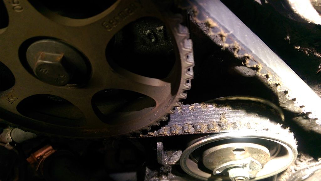

    Quote Originally Posted by Broncos10499 View Post
    So found out it was a GEBA.
    All exhaust valves are bent and a couple intake as well. But, Not even going to bother with ECS haha, Ive seen other threads on their customer service. But thanks FromS60toB61.8t for the reply. I was looking at the valve kit. Any other high performance valves that you guys use? Just want to know what else is out there.
    Please give customer service a call. Most parts come with a 1 year warranty, I'm sure if you give us a call and explain your situation we'd be happy to work with you the best we can.
    Give Chris V in customer service a call. 1-800-924-5172 ex 263.
    I'll also be in touch with the customer service manager about whether we should change the brand of water pump we include in this kit.
    Jason
    Thank you Jason I will give him a call for sure. Appreciate that.
    We had to wait for the head bolt tool to come in, so head is coming off today or tomorrow. Hopefully pistons aren't too bad
    We never like to hear things like this happening to our customers and do our best to provide our customers with quality parts in our kits. Unfortunately it's impossible to guarantee 100% against manufacture defects and the rate of failure. As we all know, even Genuine Audi parts can fail without warning.

    Looks like these GEBA pumps have been crap, and continue to be crap. Quote from B5 S4 section, circa March 2011:
    Quote Originally Posted by werewolves182 View Post
    I just looked into which pumps we use at my shop. We have had no issues with GRAF, HEPU, GMB, and APU Europarts water pumps. The one you really need to stay away form is GEBA. We have had numerous pump failures/leaking pumps due to failed bearings on the GEBA pumps. I would say you are in the clear using GRAF!
    http://www.audizine.com/forum/showth...=1#post6246137
  30. #70

    Add another person to the list with a failed GEBA water pump.
    Mine went tits up after only 12K miles!! and did the exact same damage as the OP experienced... shredded timing belt, bent valves, requiring a total head rebuild. Seriously, the pictures of my damage, are 100% IDENTICAL to OP's pics.
    I think it's pretty clear that ECS needs to get this shitty water pump out of their timing belt packages!
    4 grand? really?
    Most likely, he has a ton of bent valves. Grab a used small port head and tbelt kit and we are talking less than 1k to get it back on the road. Worst case scenario, every single piston is junk. Grab some used ones with new crank/rod bearings, some new rings, and at the very most he has 2k into fixing it.
    True, but I think the higher quote includes labor charges.
    Vorsprung durch Technik
  40. #80
    Aug 26 2005
    7741
    Sorry to hear about your misfortune. Do you by chance know what make the water pump was? I had a one go out at 55k miles. It was a Geba pump that I picked up from Europaparts. The replacement was a Hepu.
    This is why I am using only OEM coolant pumps from the dealer. The plastic impeller fitted to OEM coolant pumps is not an issue in comparison, since a cracked impeller won't wreck the engine. A seized pump bearing will grenade the head.
    BTW, Re: Prior posts, the coolant properties used in the cooling system has no effect on the pump bearing durability. The pump bearing is not exposed to the coolant in the system.
