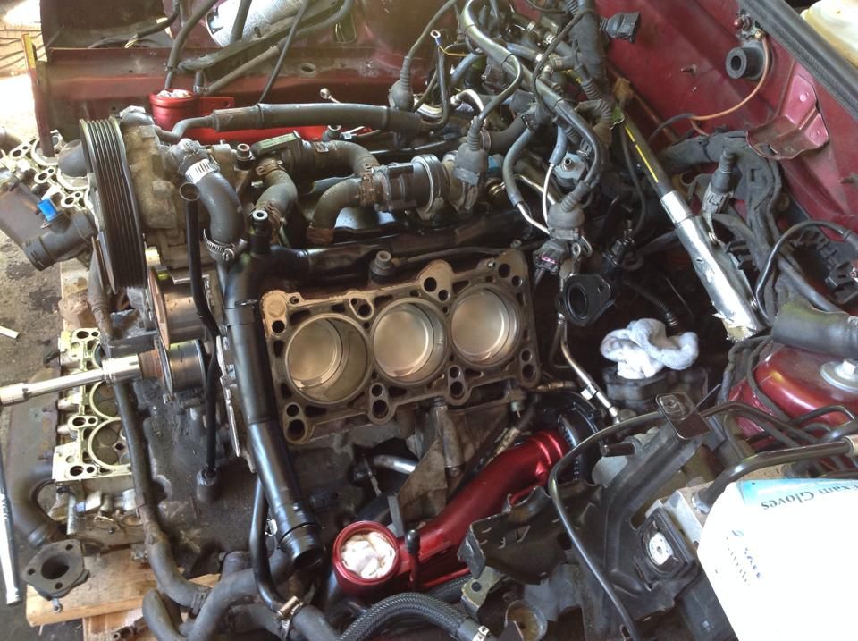

    2.7t Frankenturbo, pretty sh%t build.
    Well, I posted a thread a few weeks ago, wondering why my car was smoking. I was dead set on bad valve seals, as I had replaced the K03s with claimed "borgwarner" K03/K04 Hybrid turbos.

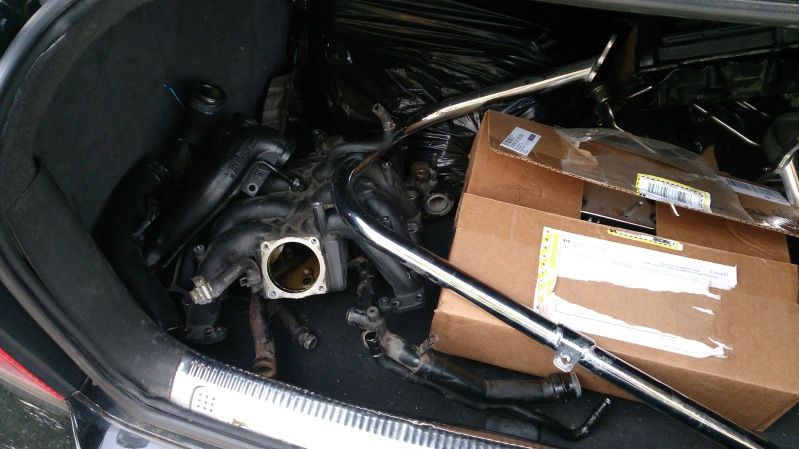

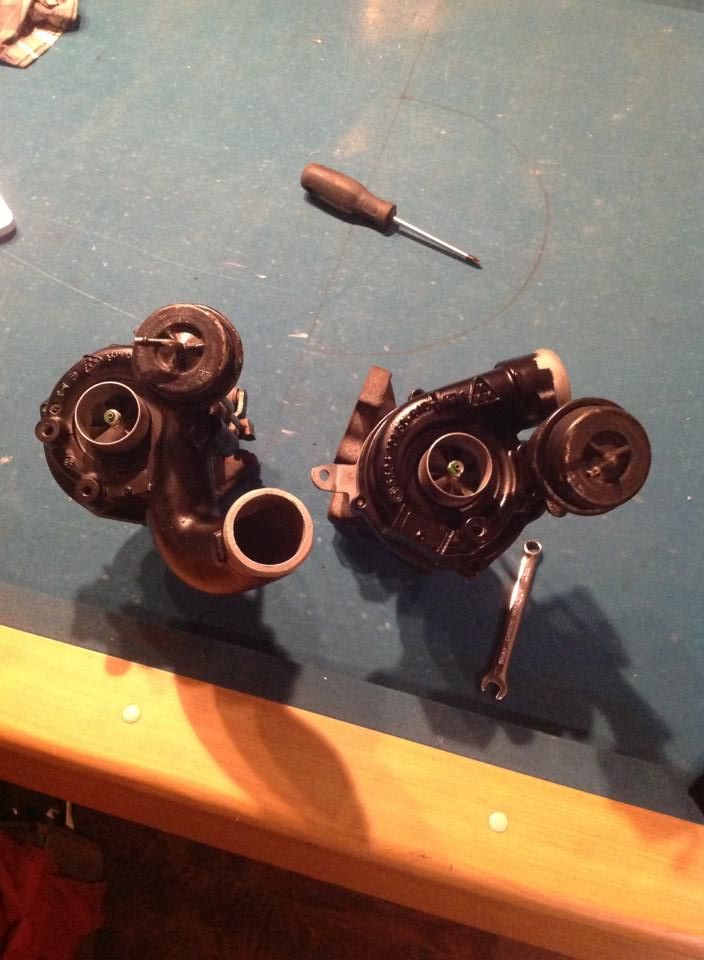

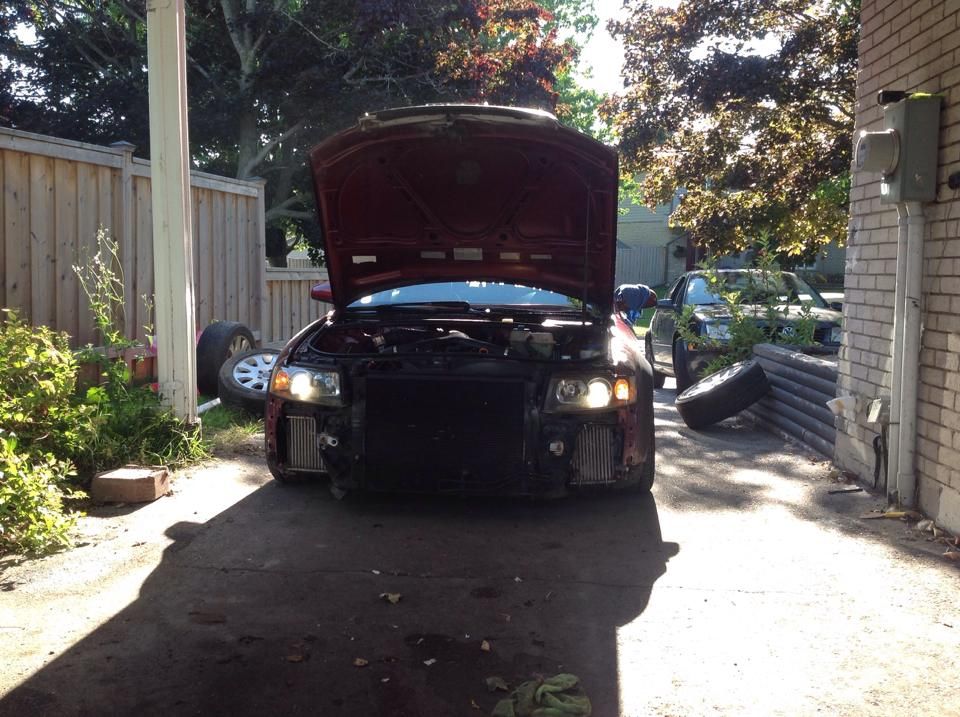

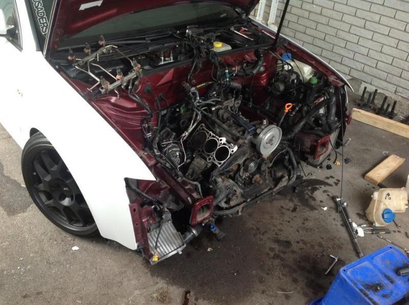

    The car was smoking to the point where I was embarrassed to drive it. So, I dropped off a set of 2.8 heads to be cleaned up with new valveseals installed. So I parked the car, and began tearing it down for prep of new heads. To my stupid surprise, I find the DS turbo has copious amounts of shaft play, and bent fins. I'll let the pictures speak
    I got 8k out of these.
    At this point with the build, I might as well commit, the car is worth nothing in this state, and I genuinely enjoy the B6/2.7 combo. It sucks I got hosed on these turbos, but Live and learn, I had bought an F21 kit from doug for my MK3 last year, with great results. Awesome customer service, and product, I cranked 262whp and 290lbs out of it
    As you can tell, I love doing swaps, I do everything myself, Best way to learn. I'm also a powdercoater by trade/hobby. So, anything metal, gets coated.
    Some randoms of the car, I know its know a B5. But its in there :P
    My goal is 430-450whp, if anyone has any tips/experience with the F21/2.7 combo, chime in. I'll keep updating as I make progress. 2.8 heads should be back next week.

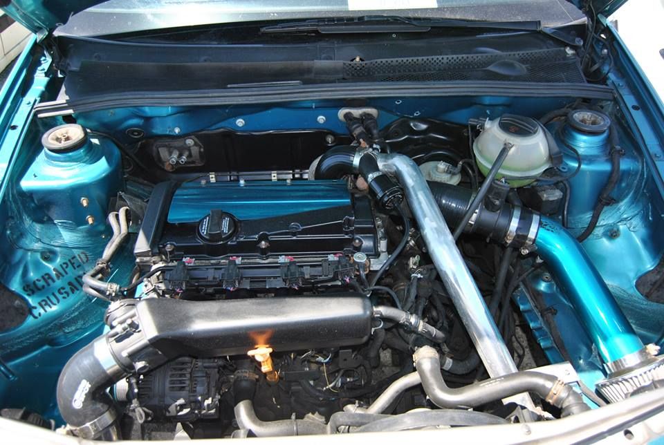

    I saw you at Eurokracy. Actually we cruised there in the same column (scrapped crusaders). I was really impressed by your swap. Keep up the great work dude.

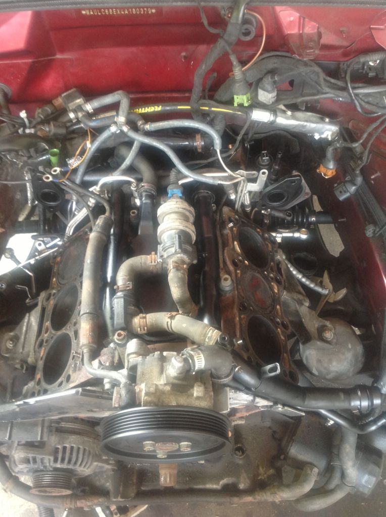

    Yeah man, pm me anytime. The 2.7 is easy to work on, Just not in an engine bay :P

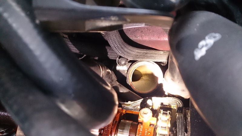

    Doesn't look like much, but I got the Crankcase cover, and coolant pipes back on, with new gasket and o-rings
    Invisible shit. But rust free.

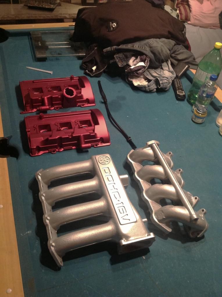

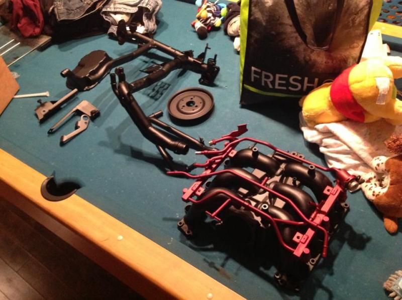

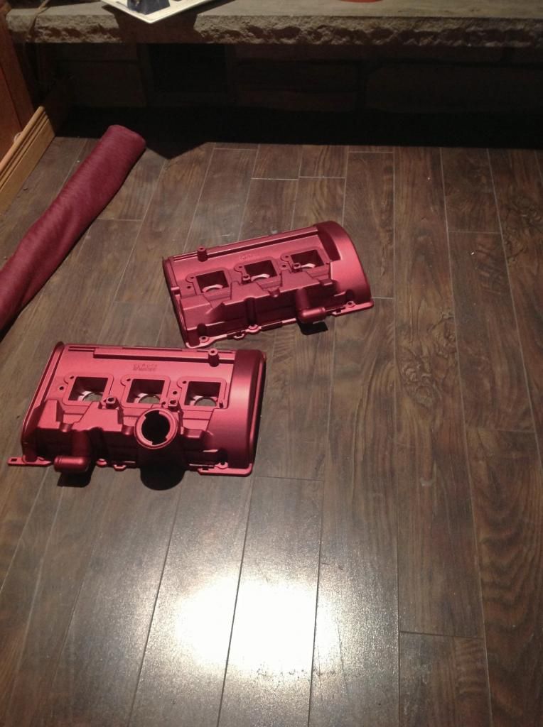

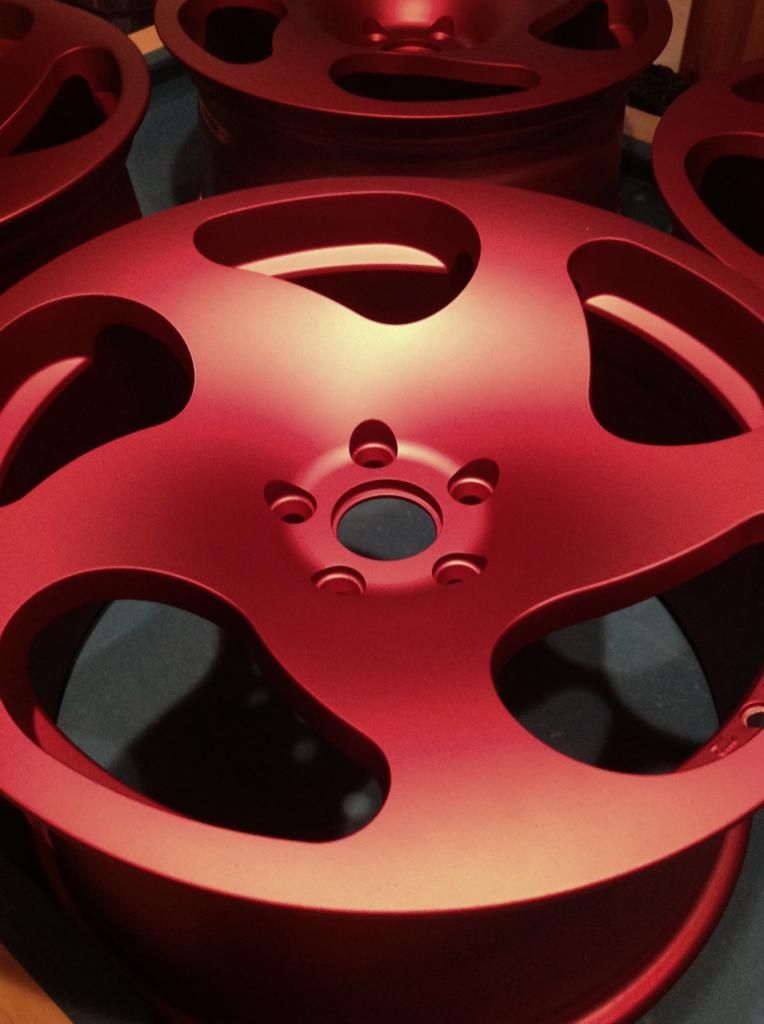

    Powdercoated the valve covers today, along with a customers 16v manifold

    That powder coating looks good! Makes me want to do it and leave my hood open everywhere.
    Senior Member Two Rings mr16valve's Avatar
    Nov 24 2013
    131671
    GreenvilleSC
    Yaay 16v manifold! (Doesn't appear to be the the highly desirable "KR" intake, but yaay nonetheless).

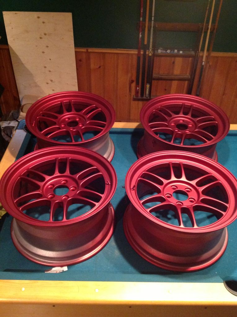

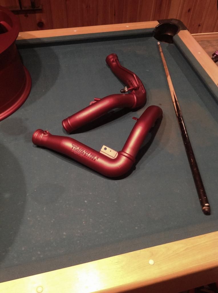

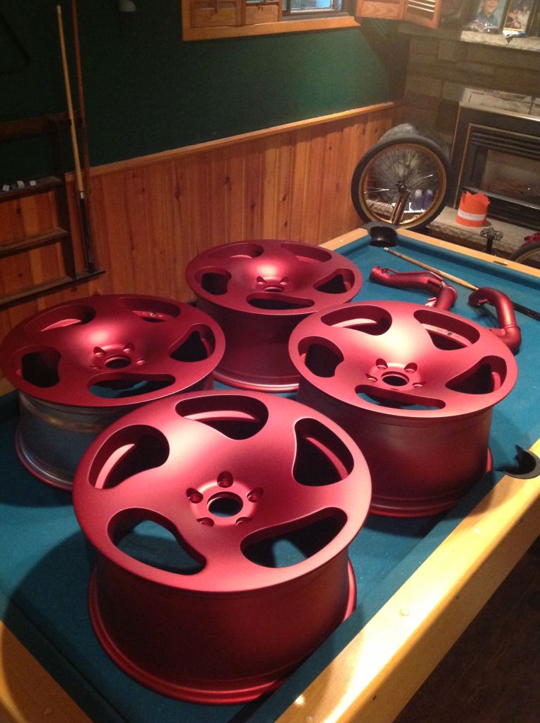

    Did work today, a buddies WCI wheels, and my charge pipes
    Veteran Member Three Rings cinimod25461's Avatar
    Dec 04 2013
    133598
    CA
    Powder coats lookin gooooood

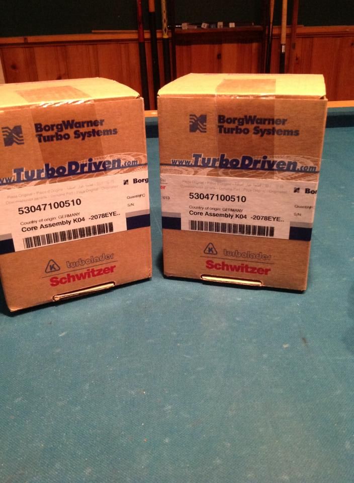

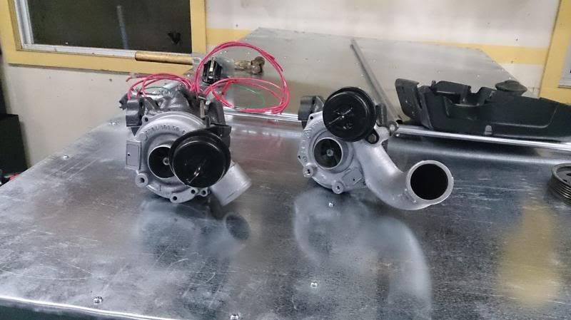

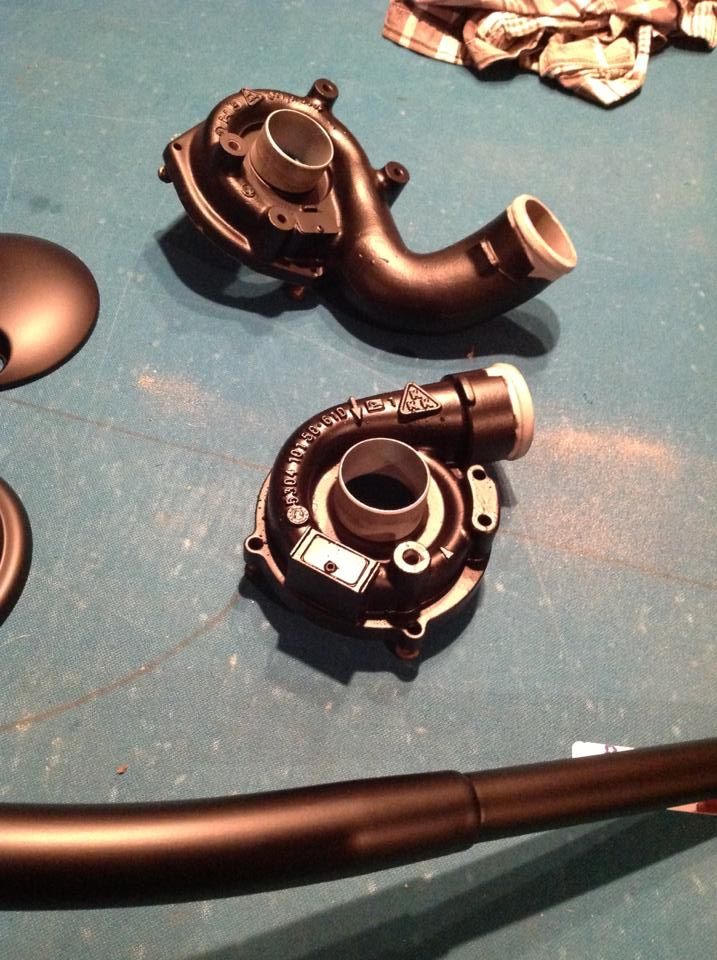

    CHRA's came in, and got them rebuilt.

    What was the cost difference in rebuilding the K04s vs new FTs? Im guessing you used the housing from your old turbos?
    Jun 30 2013
    118081
    Bowmanville
    Quote Originally Posted by 1thenaton1 View Post
    Yes I used my housings. Price difference was about $1000

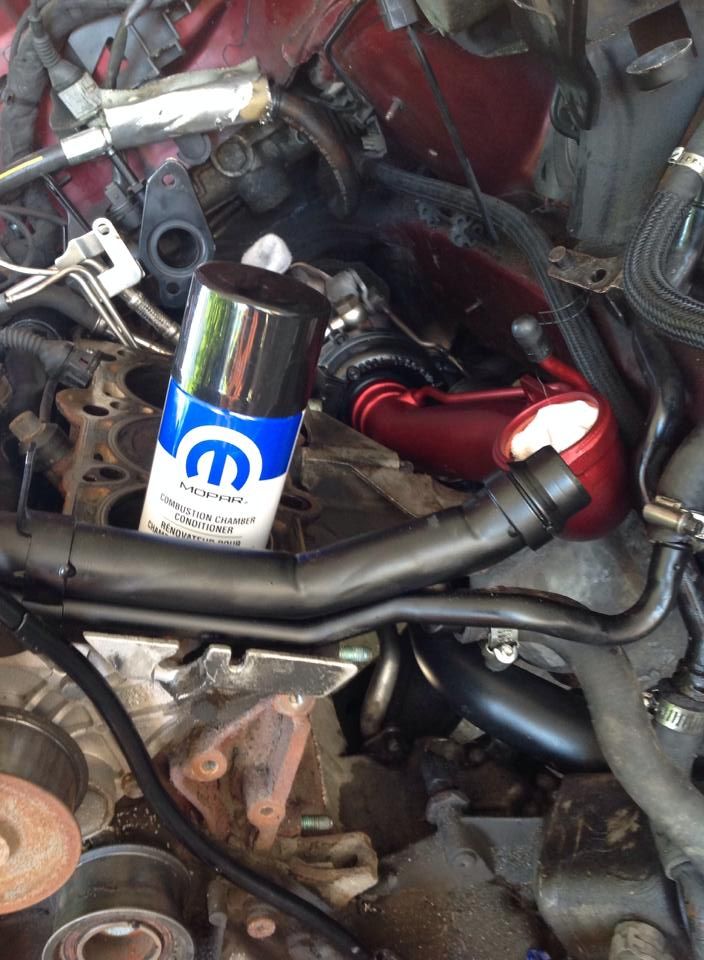

    Check this shit out. Amazing
    About 20 min of soaking, and a clean wipe with a microfiber clean up.

    wow. I'm impressed with your results from the Mopar CCC. get it from a dealer?
    May 20 2012
    93814
    San Jose
    Wow, that stuff must have some nasty chemicals in it. Looks great though!

    Quote Originally Posted by Audimilo View Post
    Yeah, $9 for the can
    Quote Originally Posted by oppositelock View Post
    Thanks, yeah it stings to the touch. I didn't do one ounce of scrubbing. Worked great.

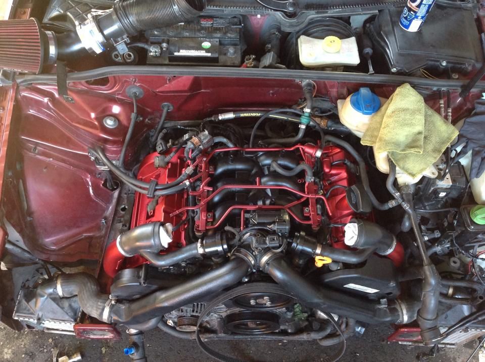

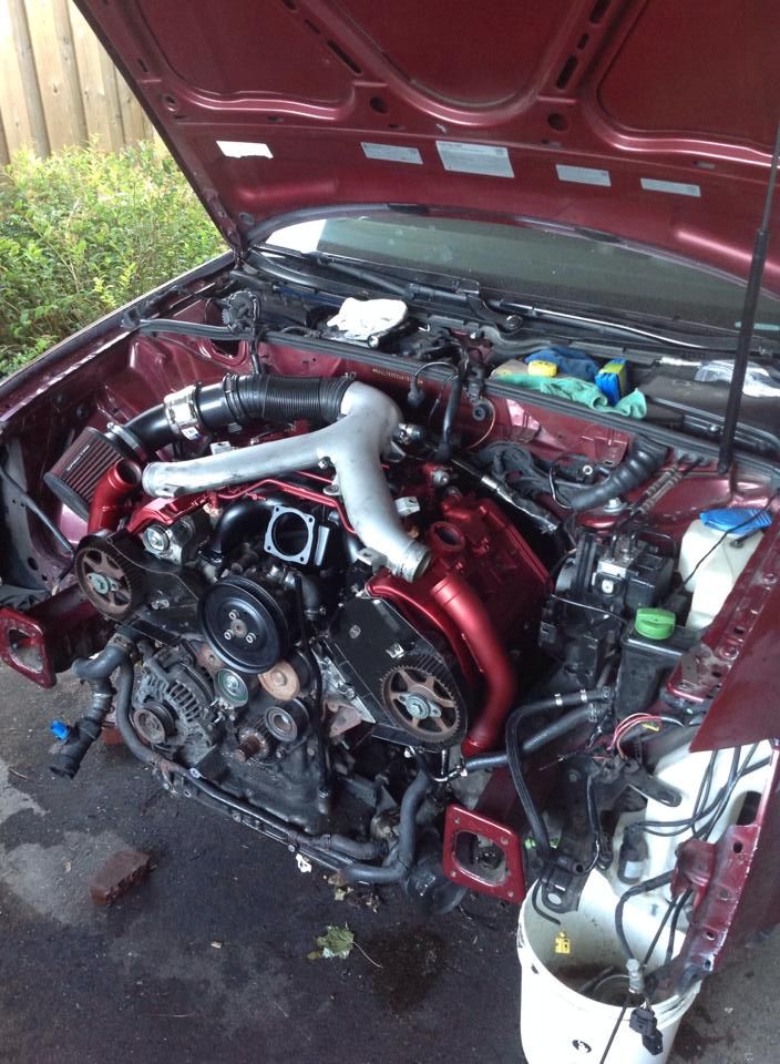

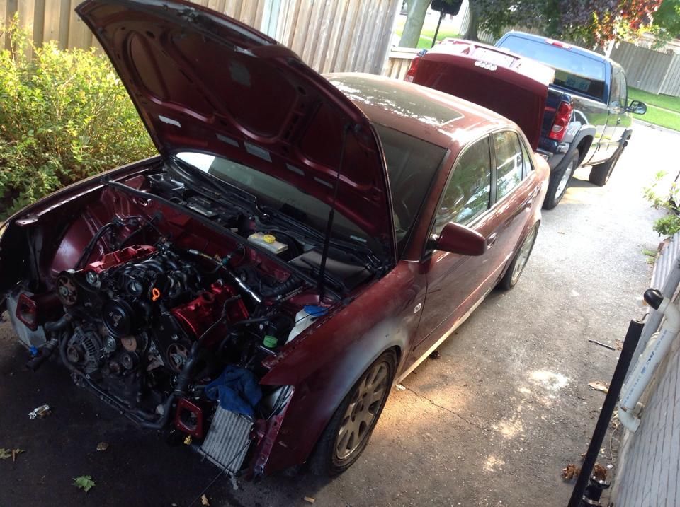

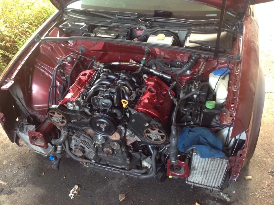

    I got the heads on, they didn't ship my head bolts, so I'm at a stand still, but I got the turbos mounted to the manifolds, and tossed on some other stuff, nothing is bolted down as I'd like to clean up a bit more grease.

    They didn't have enough VR headbolts with my order, so they just didn't ship any.. Called them, saying wtf. "you were just gunna see if I noticed or not?" Got OEM headbolts coming by tomorrow I hope.
    Should be running shortly, Sorry I didn't stick with the franks, Driving this POS is more important to me lol

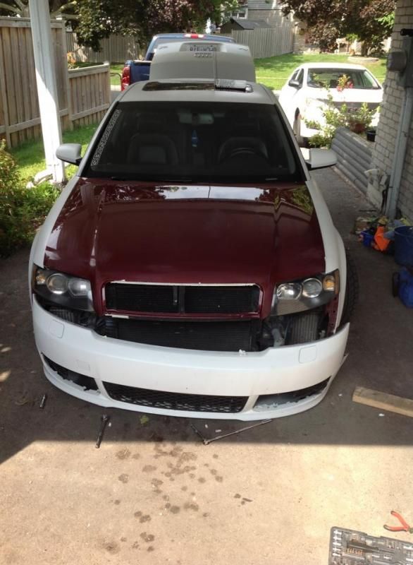

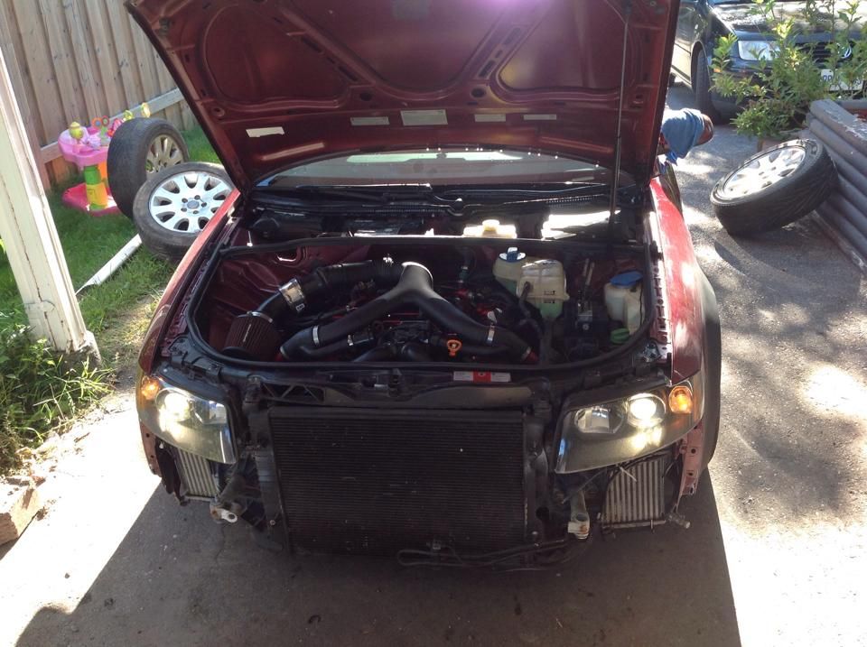

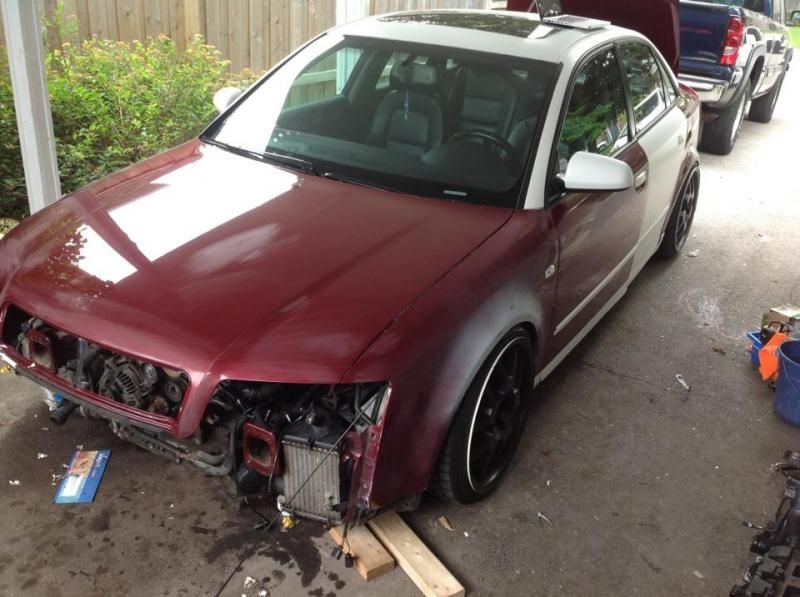

    Got it all together for the most part, front end and fluids tomorrow. Then she lives

    300k on it, no leaks, anyhwere! Its a christmas miracle lol Strong idle, no funny business. Running well :)
