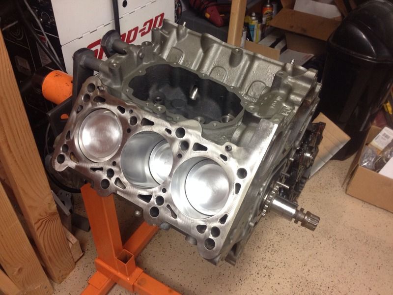

    GT2868 Avant build
    Motor coming together.
    Euro goodies from AG-M and THE
    The THE-tuner gussy dwarfs the oem RS4 Unit and is going for less!!
    In a vyvanse and redbull fueled day I polished the inside for 1hp gain
    Around this time I also got some goodies back from powder coating . 95mm maf housing and valve covers done in Harley wrinkle black.
    To compliment anodized Red IE fuel rails .
    [URL=http://s4.photobucket.com/user/GOGOTEKNO/media/image_zps0ed65c58.jpg.html][/URL
    Updated Parts List
    BF Block
    Polished 3L crank
    Wiseco 82mm pistons
    Pauter Rods
    Rockcandy billet girdle
    Autospeed GT28s
    Tial 38mm wastegates
    Southbend ss stage 4 clutch
    JHM trio
    Bosch 710n diverters
    Silly Rabbit Enlarged plenum RS4 intake manifold
    Rs4 throttle body
    THE-Tuner Metal TBB
    AG-M Bipipes
    Darkside 4bar Map Sensor
    Integrated Engineering SAI block off
    Integrated Engineering fuel rails
    1000cc injectors
    -6AN fuel line
    SRM V3 Side Mounts
    2.8 heads w\ polished intake runners
    Supertech valves
    Supertech ti valve springs
    034 intake
    4in AEM dry flow intake
    Reisu 95mm intake tube
    034 RS4 Carbon Y Pipe
    034 big bore intake hoses
    034 breather hose kit
    034 Coil Conversion
    034 3.5in exhaust
    044 fuel pump w/034 drop in kit
    044 with surge tank
    Fluidampr
    034 snub mount
    034 street density motor mounts
    034 transmission mounts
    Apikol rear diff carrier
    034 snub mount
    H&R springs/Billstein Shocks
    ECS height adjustment kit

    Update : Rockcandy just finished assembling the block , thanks to RedrocketS4 it will be home this weekend !
    Next I need to find some new 2.8 heads/cams to swap my valve train into to get this car operational .
