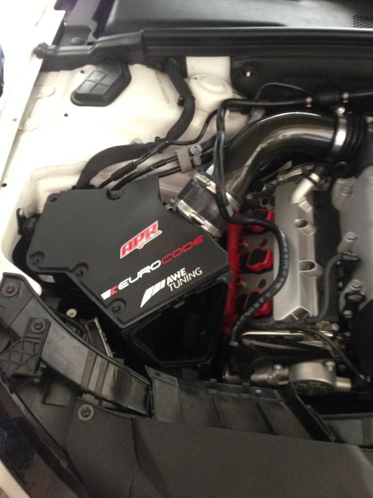

    Haha. The part from front grille to the air box.
    From the box to throttle, I have the APR CF tube which I don't think is a major restriction, but the thin CF likely picks up quite a bit of heat.
    My box is stock. Still has the downward baffles and snow screen. AWE filter.
    With the snorkel removed, I gained from 50-100 Kg/h in Air Mass. Not a lot, but it helped.

    In that current config the snow screen is no longer causing you a restriction. The downward baffle is however. Unknown how much, but it is blocking some airflow and direction. What filter is inside the box? The K&N that comes with APR's intake?

    AWE filter. Definitely no issues with the snow/bug screen right now.
    This is a short term setup.... I have a CTS intake (Roc-Euro clone) waiting to go on, but they have not been able to provide the correct hardware to install the heat shield. First, there was no hardware at all (or vacuum hose extension). They sent me some parts yesterday and the vacuum hose now works, but the mounting bolts are 2-3mm too big for mounting holes in the base of the heat shield.
    I'm probably going to tap out the holes to make it fit, but the whole thing has been a PITA. Thomas from Emmanuel Design where I purchased it has been very helpful and CTS has been responsive, but it's taken a month to get to this point. It looks like a good intake if I can get it on.... I could go buy new hardware, but I want to make sure they remedy this so others don't have the same issue versus letting them off the hook.
    I have tried to install it 3 different times with no luck. The good news is I can install an intake in about 5 minutes now....

    Echoing what was said earlier in the thread, I also noticed performance problems in the intake system. My solution was the "stage 2" APR pipe, which is a nice tensile tube made of an appropriate amount of carbon fiber, and the AWE S-flow filter in the stock airbox. I kept the airbox stock purely for CARB legal emissions in California. They really don't like it when you mess with the airbox, the cats, or the gas cap in this state.

    West, the intake system problems you thought you had in the past was due to you thinking the 034 tube you had between the box and TB was collapsing on you. The stock one is rigid enough not to do so and what was reported by Arin here was a collapse of the small section between the box and front grille pickup.

    I like how you can't distend the APR tube. It keeps nice smooth airflow going. The soft body tube is more a diaphragm, flexing and flattening as vacuum forces as placed on it. I realize the full volume isn't compromised in the stiffer tubes, but they still oval.
