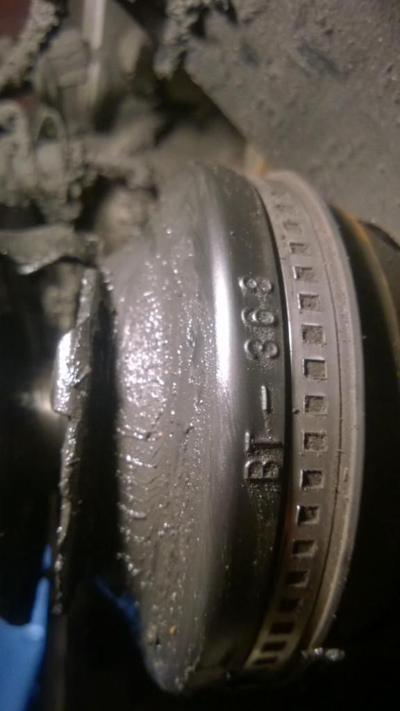

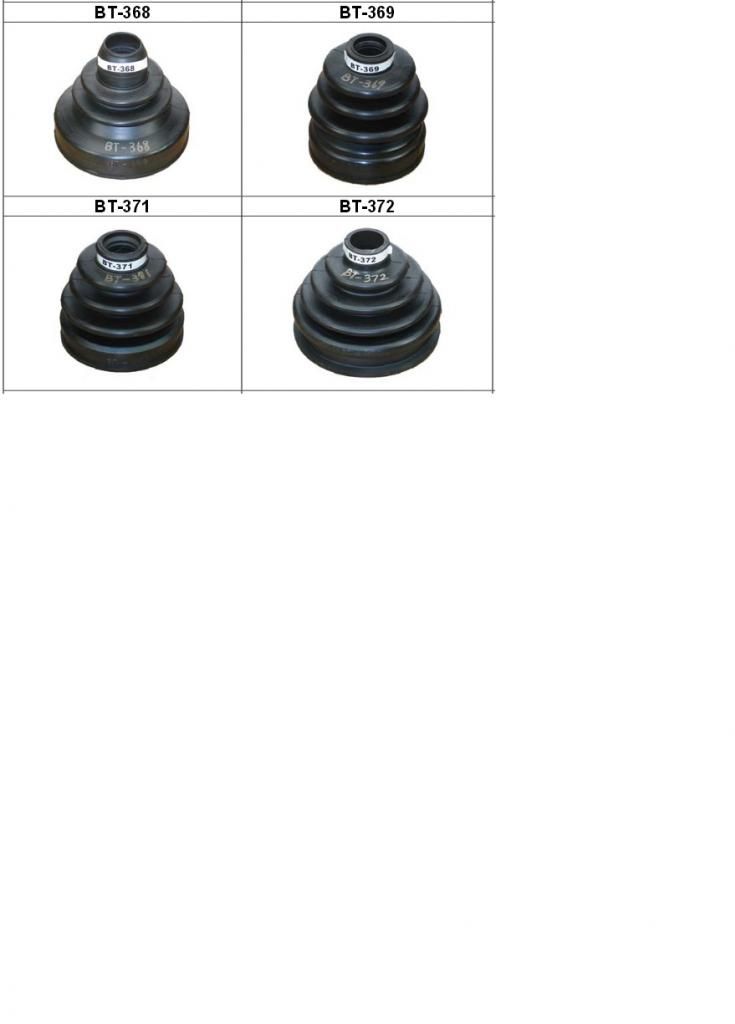

    I just looked up the cv boot part # BT-368 in question (which Is on my car) and came across a PDF http://www.autodemarreur.com/CV%20Ca...10%20KOTEK.pdf this pdf shows that boot that tore is for a 95-99 bmw m3 outer cv and for a bmw 91-97 840ci- 850i 98-99 M roadster 00-01 Z3
    I scrolled through the list and got to audi and the specified cv boot 01 front m/t inner bt-036 outer bt 372
    the bt 368 dimensions are #253 on the pdf bt 368 top id 1.032 bottom 3.787 height 3.228 neoprene
    the bt 372 dimensions are # 257 on the pdf bt 372 top id .937 bottom 3.512 height 3.402 neoprene
    the RIBBING however is completely different and the audi cv boot looks like it can have much mroe of an angle then the bmw boot. GRRR
    So the height is a little lower ont he one installed on my car which could be why it is tearing.
    Who has DSS axles in their B5S4 and can you please check the boot model # the number is right next to the larger clamp. Ill post another thread to check this out but if you have them please check out the part # and post the part number of your outer cv boot in here please. all help is appreciated.
    heres the boot on my car and pictures of the differences between the bt 368(bmw boots) and the bt 372(B5s4 boot) looks like the angle of turn is limited much more on the bt 368. I may have found my problem. Ive spent $350 to have the first torn set instaleld only to have them tear due to improper cv boot from the start. I definately need other members to let me know what outer cv boot is on their dss axles, pictures will help ALOT.

    BT-372 is the way they should look like for the front outer CV-joints.

    I've never seen a boot like the BT368 used as a front outer boot on an Audi or even a VAG car. The 368 style boot is usually an outer rear type boot. I don't think it would give you enough flexibility for an outer. The BT372 is much more like what I would expect to see as a front outer boot. I would suggest giving a pair a try and let us know how it works out...

    thing is the dss CAME WITH the bt 368 boots. even in their pic on their site it shows that boot. when the cv boots tore the first time they were an exact match with the boots dss sent for free. so they use the bt368 on them. Im pretty annoyed by this the mroe I think about it because I spent $350 to install the new boots and that is two times my boots blew hence wearing the components and I paid $999 and I also sent them two sets of OEM axles to give me a deeper discount only to have them say one of the sets of axles were no good at all. So now I have no set of spare axles to install. this car is my DD. GRRR
