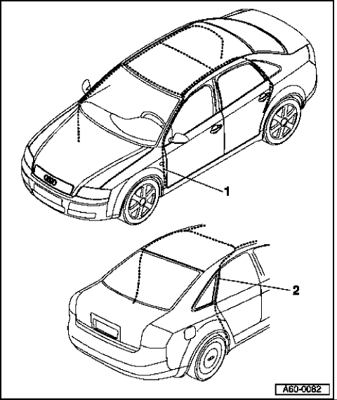

    Re: Sagging Headliner!!!HELP!!!!
    Can anybody confirm how you unclog those sunroof lines.

    Senior Member Three Rings Cyrix9445's Avatar
    Dec 05 2006
    13931
    2004 S4, 1995 Wrangler
    Orlando, FL
    Quote Originally Posted by haroulli View Post
    maybe some household drain unclogger? lol i dunno, but the dealer just replaced mine, i THINK they were pretty cheap, dont know how involved it was though
    Service and Repair
    Water Drain Hoses
    Water drain hoses, cleaning
    NOTE: For cleaning we recommend a self-made tool from cores of speedometer cables with probe approx. 2300 mm long.
    1 - Front water drain hose
    Front water drain hoses -1- are routed through A-pillars and end between door and A-pillar. Clean from sunroof opening.
    2 - Rear water drain hose
    Rear water drain hoses -2- are routed in C-pillars and end at sides behind bumper cover. Clean from bottom end of hose, removing bumper cover to do so.

    I was driving my B6 yesterday and when I arrived home, I put it in reverse, turned around, and saw my headliner started to sag just like in the first few pics!!!
    I plan on re-covering the headliner myself. Does anyone know of a source for OEM-type fabric found on the B6? You know that textured fabric that feels kinda like nylon. Thanks in advance!
    Been there before, make sure you fix/seal the drain plugs so it doesn't happen again to your new headliner.
    Read this thread to find out more info.
    It doesn't always happen due to the drain plugs. Mine sagged simply because the adhesive/foam bond failed. Possibly poor quality. I'm not sure if this is a common thing and all cars' headliners fail at 100k/10yr, or what, but it seems like a common thing for B6's (and many VW's) with the light-colored headliner. I removed the pillars and the fabric is extremely difficult to rip off. However, with the headliner, it takes barely any force to peel the old fabric off, due to the failed bond..
    I know it was not my drains that caused this, because they have never leaked (I have since done the "fix" as preventative maintenance), and the fabric sagged off in areas nowhere near the drain tubes.
    Vapor, it's not OEM, but looks good IMO. Maybe you want to check out yourautotrimsupply.com (or whatever the website is called, its something like that).
    Hard to believe since I thought the adhesive/foam bond failed only when exposed to water...do you have any stains at all? Even light ones in the areas they sagged???

    my headliner recently failed out of the blue, no exposure to water. I'm guessing just time + heat cycling of the foam/glue.
