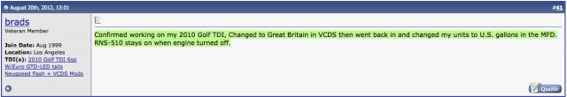

    Found this thread for the radio to stay on. Apparently the country code must be changed using VCDS, however I'm not sure how if it messes with the units for speed (i.e. mph vs kph) and temperature (Celsius vs Farhenheit). Does anyone have any insight?? By the way, I only have AMI (non navigation). Can thi and the length of time the radio stays on be accomplished for us with AMI??????
    http://forums.tdiclub.com/showthread.php?t=352523
    http://forums.audiworld.com/showthre...2823719&page=2

    By the way, I am getting a hold of someone with VCDS today and will attempt the country code change to Great Britain to see if that allows my radio to stay on when turning the car off. I will report back with information. If this is successful, then I will have cracked the code to my 1st world problem.
    From TDIClub Forum:
    "I tried both GB and Germany, as well as Rest of World. Germany is better for Canadians because it doesn't by default use gallons, miles, etc. Anyway, yes, same procedure.
    To change country code:
    - click on 17 Instruments
    - click on Coding
    - click on Long Coding Helper
    - change drop down country selection and save changes
    Apparently, for non nav cars...
    ...You need VAG-COM cable to change from 1-99 minutes:
    [56 – Radio]
    [Adaptation – 10] -> Channel 03 -> default, you have 10 (ten minutes change from 1-99 minutes

    I tried today. I changed the country code to Great Britain but nothing changed as far as the units which makes me unsure whether changing the country code works or not. My search will continue until I find a solution

    The coding you posted was also in the link I posted and THAT WORKS!!! I changed mine to 99 min, so now I can listen to the radio for up to 99 minutes after restarting it. So that is fixed, but now I need to find a way for the radio to stay on when I shut the car off.
    This BMW forum suggests the issue is in the fuses. http://forum.e46fanatics.com/showthread.php?t=766585
    I'll give that a shot next.
