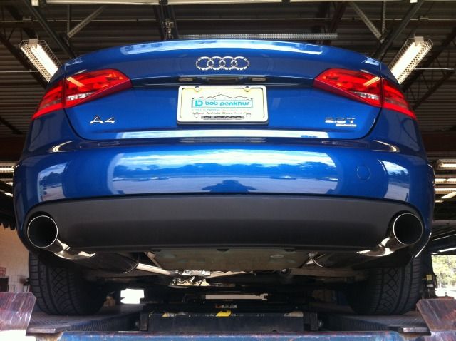

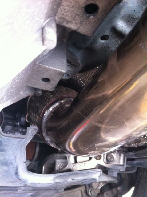

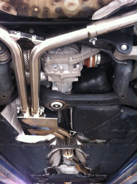

    Pics of my STaSIS exhaust installed:
    Hope this helps!
