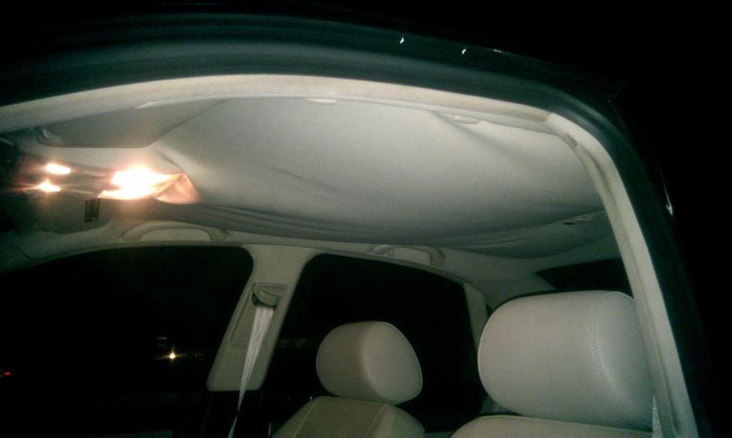

    So my headliner fell
    So guys I took a trip and had to park my car on the top level of a parking garage in Miami and it got cooked. So I was wondering what are my options?

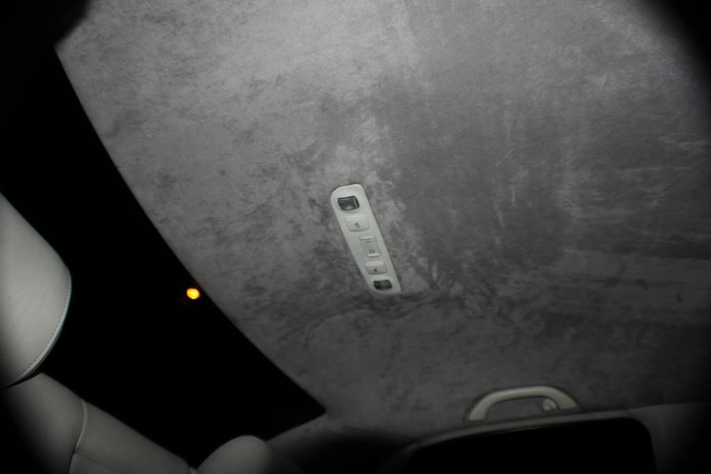

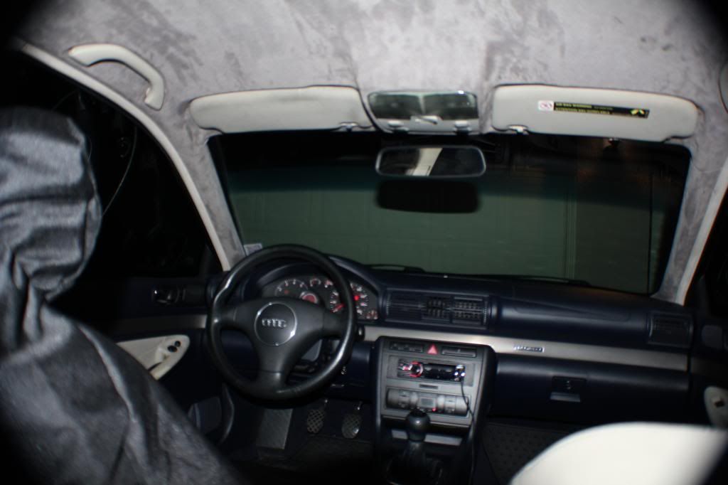

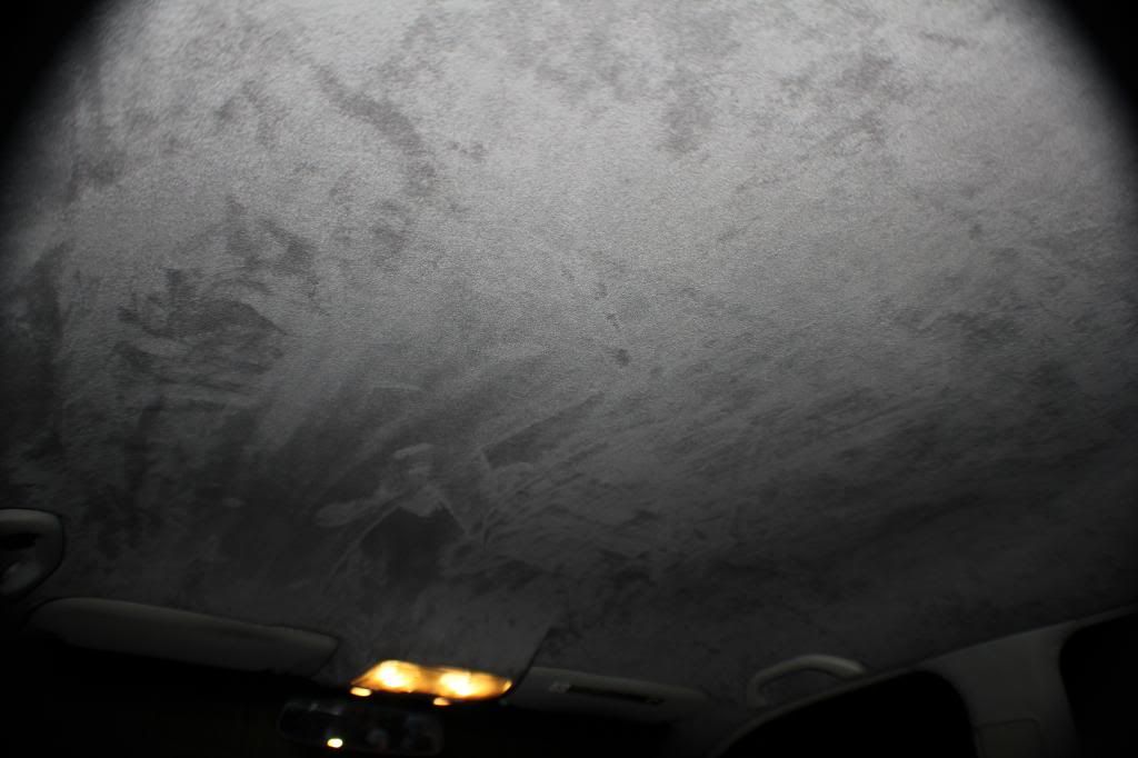

    Had the same problem with the sag. Took the headliner out, scrape off the old glue and foam, bought suade cloth from local Michael's craft store and 3M Adhesive spray glue. Had it for 3 years now and so far, it stays.
    Edit: DO NOT use other adhesive spray other than 3M...ask me how I know....It's not fun doing it twice.

    How did you get the suede around the curves in the front?

    you forgot to do your sun visors 0_0

    OP: I'm not sure what part you're talking about, the pillars or around the light switch but I removed all the pillars and wrapped them. Be careful not to break the tabs. Also, for around the light switches, just use a shit load of glue, spread it evenly or it will seep though the material.
    Grapebandit: As for the visor....I just got lazy...but now that you mentioned it, I think that'll be my next project.

    Don't remember, but it didn't cost that much, no more than $20. Also, I scraped off the foam.
