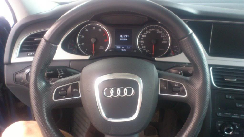

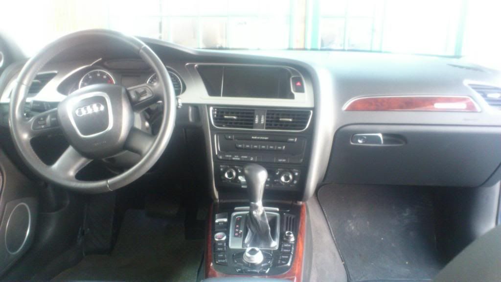

    Just upgraded my steering wheel!
    Finally after a couple of weeks doing some research about the DIY for the steering wheel and airbag harness I switch it up.
    I got the steering wheel (3 spoke with paddle shifters) from another a4 b8 for $40 bucks without the airbag, then I realized that the airbag from my 4 spoke wouldnt fit, but fortunately I had an old a4 b7 steering wheel with airbag, so what I did, i grabbed that airbag and hook it up to the new steering wheel using the harness of my 4 spoke airbag for proper function and with the vagcom adjusted the paddle shifter option on.
    Here are a couple of crappy pics:
    Before
    After

    Was it a easy process bro? Or is it really involved ? I would love to slap on a flat bottom s-line/s4 steering wheel .

    The airbag harness wasnt a direct fit, because the airbag was from a B7 platform and the yellow plug is slightly different so I used my 4spoke harness and replaced it.

    It took me like 10 minutes to take off the steering wheel, then like 20 minutes trying to change the yellow harness (airbag came from a B7 steering wheel) and to put back the steering wheel another 5 minutes, then 2 minutes to program the ecu to activate the paddle shifters.
    Its easy having the right tools and doing the correct research
