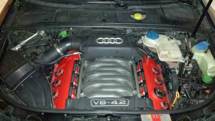

    UPDATE!
    Work was finished on my car Thursday afternoon. I had all of the parts p3u listed in the first post installed along with several other maintenance items.
    When I came to pick up the car Friday night, I asked if it had been started that day, and my tech said it hadn't. So I turned the key and it sounded like a different car! Very smooth, with no unpleasing sounds whatsoever. "Excellent!" I thought, "but we'll see over the next few days."
    I start the car up Saturday morning, and again I'm pleased to hear no negative engine noises at all. In fact the exhaust seems more pronounced; I really notice the Fast Intentions "roar to life" on startup that I was apparently missing before.
    Day three: today I startup the car and again, she's smooth as butter.
    So I'd like to thank p3u and crc for finding this and telling the community about it. I have a renewed sense of excitement about my future ownership of my car.
    Obligatory completed engine bay pic. (yeah, it's dirty):
    I have the original valve covers for sale in the classifieds section, by the way.

  31. #271
    Jan 11 2014
    138689
    Bournemouth
    Quote Originally Posted by 01northernS4 View Post
    So dealer is saying approximately 3 hours for this job and the parts below:
    2 x Oil check valves - 079103175C $61.00 each
    1 x Oil spray jet - 079115540A $33.00
    1 x Valley pan gasket - 079103161D $22.00
    1 x Oil filter housing O ring (double D) - 079115111A $8.00
    1 x Oil filter housing O ring (single O) - N90959701 $3.00
    I was told these parts may be needed also... what do you guys think?
    1 X Throttle Body Gasket 079-133-073A $3.27
    1 X Oil pressure switch 06A-919-081J $27.00
    2 X Intake manifold gaskets 077-129-717Q $36.00 each
    At this point, the valve cover gaskets have been changed and now this... does this cover all possible oil leaks from top half of engine? Valve covers were pissing and it seems the only leak left is coming from under the manifold where the valley pan is... also, my car has 90k km (55k mi)... is this normal for our engines? Seems to be an excessive amount of work for a relatively young engine... and I've gone through 2 serp belts also... one only lasted 15k km... dealer said the oil from the valve cover gaskets and valley pan led to the serp belt disintegrating...
    Does all this sound normal? Not liking the frequent trips to the dealer...
    Thanks again.
    Fuck..g hell... Thats expensive! I didnt know that in US prices will be that high :-/
    My car have 53 k miles and i did same job to replace this valves. If that will help for rattle than i dont think is too expensive or took too much time ;-P
    Will see tomorrow when ill run car.
