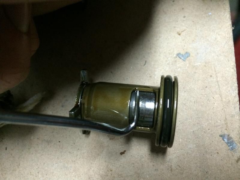

    Just did this Saturday. My check valves were closed but after i did this it has a better start up. However! look what my old valley pan gasket looked like!
    Any one have this happen to them? Worried about the peeling in the motor, i cleaned it really good but can anything get stuck or is it all burnt/in oil pan?
    Figured i would run some oil through there to try and flush it out, otherwise she is purring great and starts up smoother!

    Exactly the kind of material that can hang a check valve or clog an oil passage that would lead to rattle or worse. Good catch!

    Mine looked like that, too. Good times!

    I just did this at 190kms (118k miles) and rattle seems to have gone away on cold start. Check warm start later - hasn't even been an hour yet.
    However, on idle, the car seems to be struggling - very similar to a vacuum leak but I've plugged everything back in.
    But here's the caveat, when tearing into the beast I came upon the crankcase breather hose that links up to the PCV valve and found it was actually split open where it clamps to the valley pan.
    See pic below
    So we MacGyver-ed it with some basic plumbing skills (for now until the replacement hose arrives) and put her back together again and started her up after a little spin around the block, drew into the driveway, she started idling roughly.
    What boggles me is that it didn't idle like this before we fixed the hose let alone doing the check valve fix.
    Any ideas? Everything should be torqued pretty well and I'm pretty sure all hoses have been reconnected.
    UPDATE: Just started her up. symptoms still there. Gave her a good rev and symptoms gone.

    When I did the same check valve service my hose got fucked as well, changed it and problem went away
