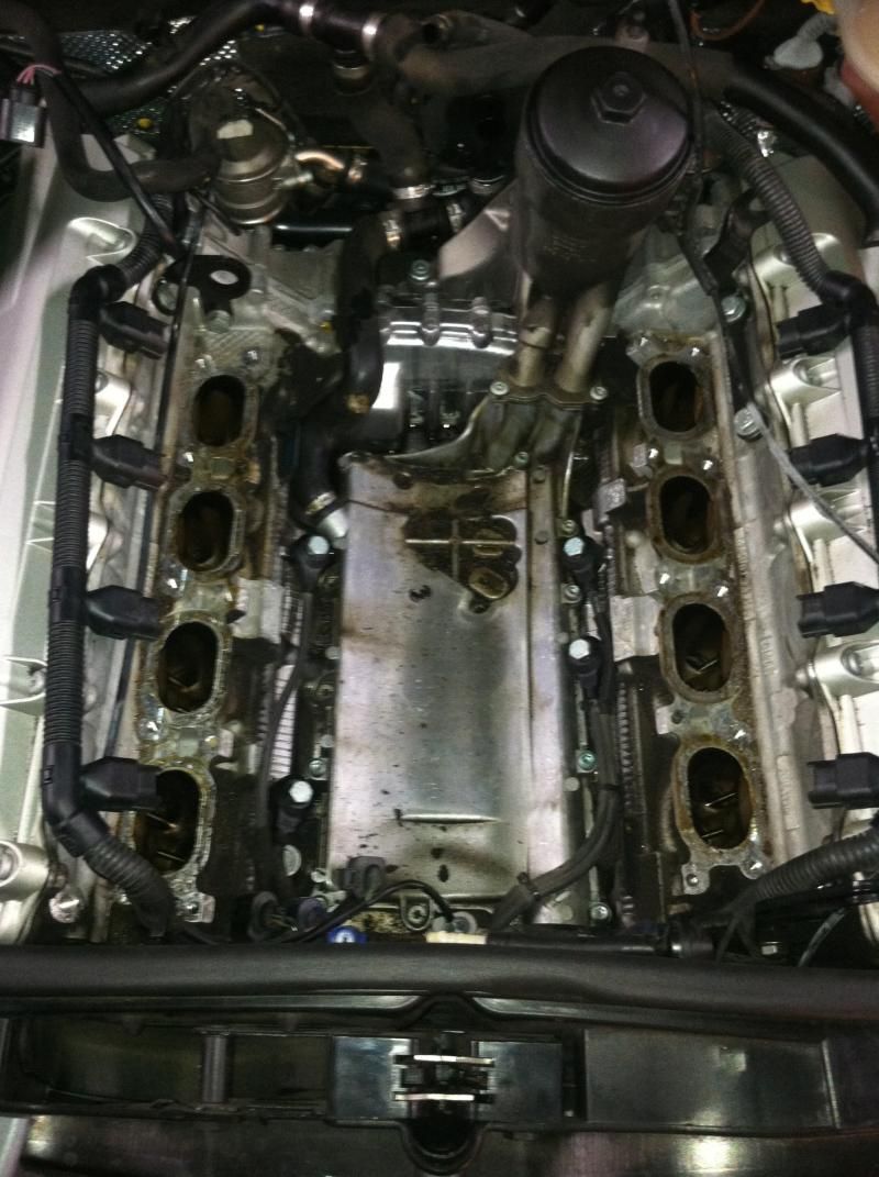

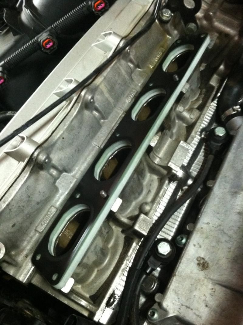

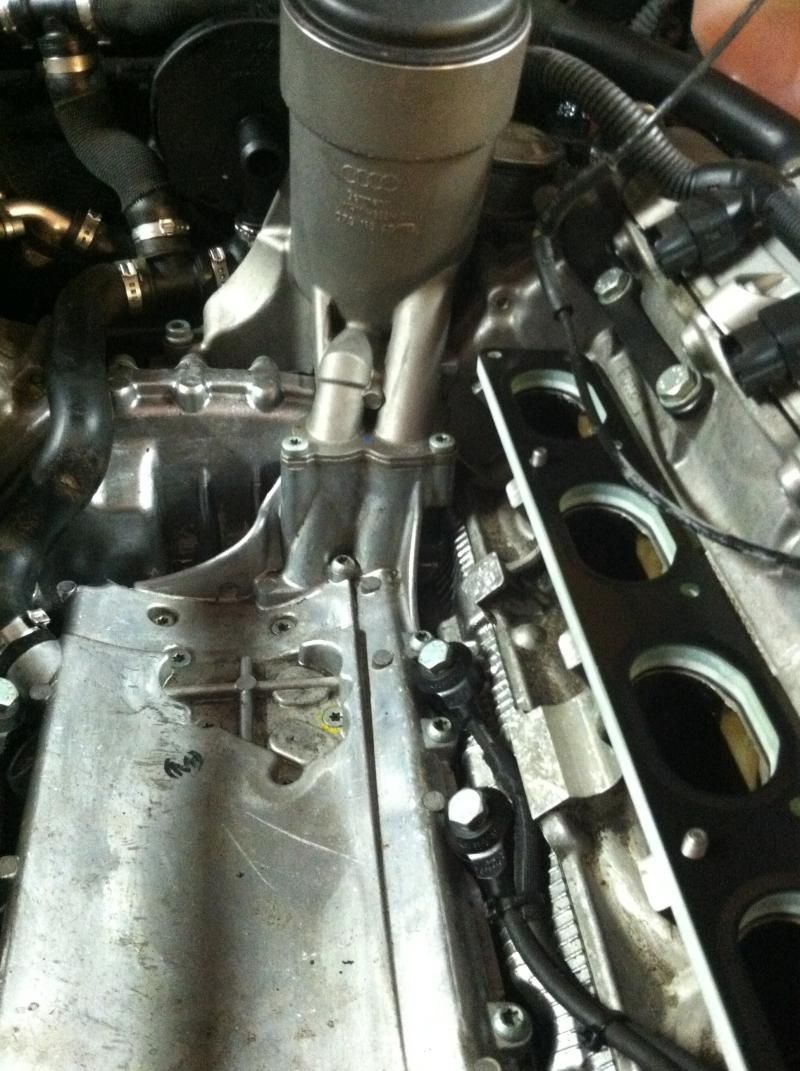

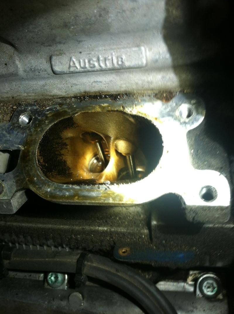

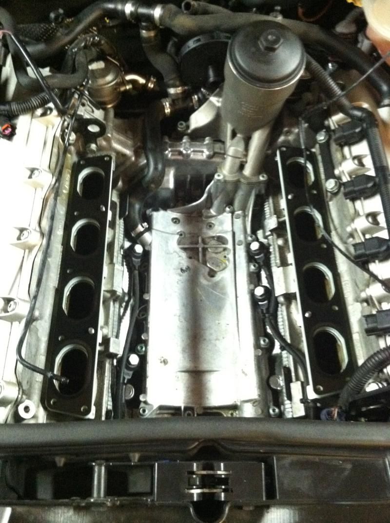

    Did the install today with my Audi tech friend at his place. Original valves appeared to be functional. Initial startup after install had slight rattle, then a few starts after were quiet. Had one rattle when warm. I will update with more info over the next days and week(s) I installed JHM spacers while I was in there and also replaced my PCV and suction jet pump too.
    Here are some pics. (I cleaned up as you can see, but didnt go too crazy).
    Before
    After
    Valves all looked pretty clean
