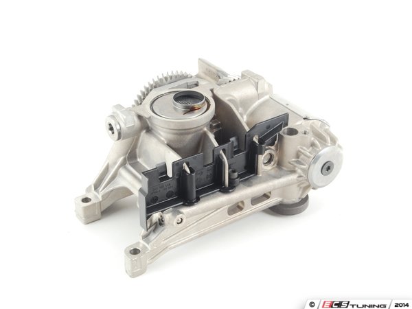

    http://www.ecstuning.com/Search/06c103273h/ES280190/
    This is the 3.0 pump. No pick up tube as the whole thing sits below oil level in the pan.
    Can anyone post the removal procedure for the 3.0 pump if it is in the Bentley?

    Hmm. I wonder if the 2.7T/2.8 30V pump would work. I know the 2.8 and 3.0 block is similar, and the pump layout looks similar as well. But the 3.0 pump appears to have a balancer shaft built in. Perhaps not entirely necessary.
    3.0 pump (1 million dollars):
    2.7T/2.8 30v pump (eleven dollars):
