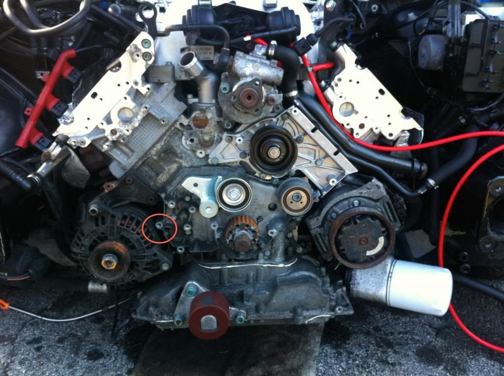

    i circled the problematic thread hole. and it appears to be the crankcase cover as shown above.
    so now all i have to do is figure out what the hell to do now!
    what are all my options, replace the cover or try helicoil, anything else??

    Quote Originally Posted by ionicswing View Post
    thank you!
    I would use a helicoil and never think about it again. Or drill and tap up to the next size, then drill the new tensioner so that your new bolt fits.
    Or..... You could weld the hole close, then drill and tap for the normal bolt. This is probably the best option, besides getting a new cover. I have used helicoils before, and none of them ever failed. I tend to prefer to just drill up a size, but since the tensioner is pre drilled, I dont think youd fit a larger bolt in without drilling it.

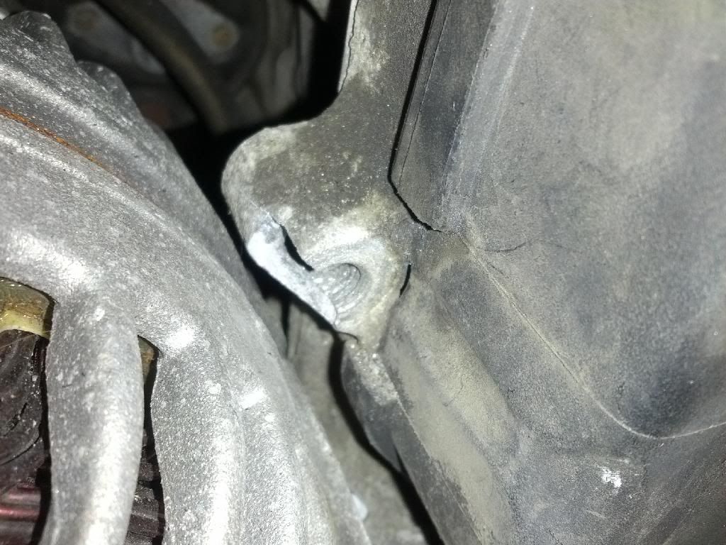

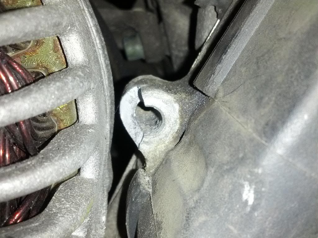

    got some images!
    one thing of concern that i noticed on the top image is that it appears to be further cracked.
    furthermore, can this be re threaded etc?

    Can't be rethreaded from what I can see. You look to be missing one of the sides. Maybe have it welded if you can't find a decent priced cover
