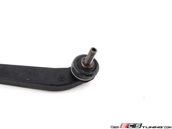

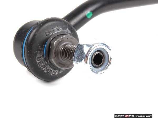

    You did say you never had to touch any of the upright bolts.., but that's beside the point. "This will save you A LOT of time since you don't need to touch any of the bolts that hold the rear up right in. "
    Also, since you didn't seem to know.. the sway bar link has a 16mm slot on the bolt for a wrench to hold it from spinning.

    Brain fart, thinking too many things at once.
    Quote Originally Posted by Timtheguru View Post
    HA! I wish I knew that at the time

    Yeah, the boot over time will cover it, so you have to push it back to reveal the hidden gem! :)
    At first I was like no way.. I have to see this for myself..
    Upon looking.. OEM doesn't have it but I then noticed...
    Key for allen wrench.
    Further digging revealed the Holy Grail
    Apparently OEM plastic ones have the key for an allen wrench and aftermarket metal ones either have the slotted base or allen key slot, sometimes both.
    Jason
