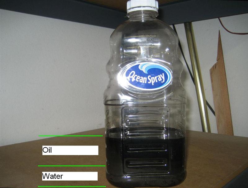

    Mann ProVent 200, 10k mi drain collection (drain every 2k miles)
    I do not plan to vent the ProVent to atmosphere. I have read many accounts of this causing poor idle and loss of power, and I agree that this would cancel out the scavenging effect of the PCV system.
