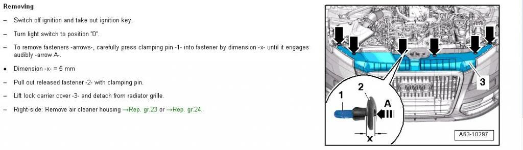

    Probably a simple question for you all. How do I remove/pop this clip
    As the headline says.
    I just need simple instruction. Do I need any special tool?

    You do not need special tool

    I tried... but failed. I can't get them out.
    "Pull out"? With what? Clamping pin? What is that?
    I broke one by pushing to hard in the middle...
    Wow, if I'm having problems with this.. How am I gonna remove that bumper... bummer.

    Push the pin halfway down and then complete fastener pull up

    I did... but can you please talk baby language right now (feeling really stupid) of how am I suppose to pull it up? With what?? How?

    With a small screwdriver or if you have something like this: clip molding remover

    But with small screw driver, you mean I should put it under the "hat" of the screw and lift...? Its really stuck...

    Yes put the "cap" of the screw and lift up. It is so simple, I do not know how to tell you otherwise explain

    Yeah... it sounds easy... But my clips won't come off...
    I have already destroyed 3 of them... I'm not touching the remaining 5, and will go to the Audi dealer to freaking show me.
    nr1 - pushed to hard in the middle so the clip went through
    nr2 - it came off, but broke 1/4 legs
    nr3 - i tried with screwdriver, and then scissors:
    A second after I took the pic, the hat of the clip came off...
    I have no idea why they are in there so freaking hard..

    Well... it's gotta be that tool... Cause it makes it go straight up. I tried to pull with my fingers straight up, scissors straight up... No results...

    I removed on two Q5 and two A4 without problems (with screwdriver). I really do not know what the problem is with your.
    You can buy from the dealer package (8 pieces) price 2-3 EUR
