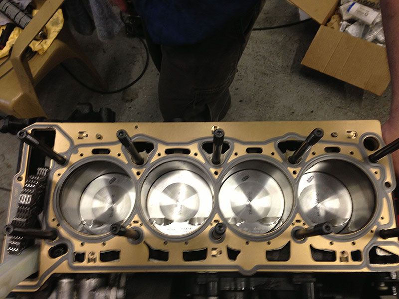

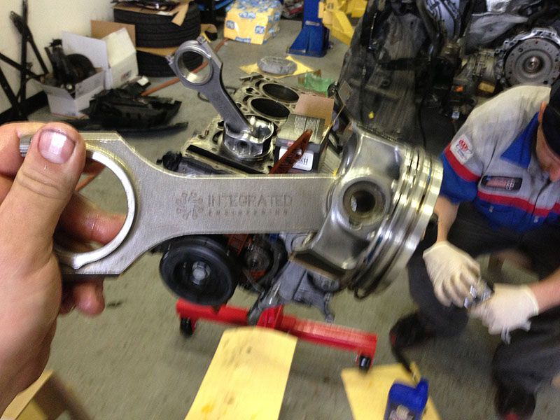

    I was wrong he did do some cylinder head work...
    Quote Originally Posted by bhvrdr View Post
    The new timing chains, guides, tensioners all went in. The new pistons and the IE rods are in...
    The cylinder head is being completed at the machine shop now with new seals, flow enhancements/porting. Hoping to have that back next week and have this buttoned up in 7 to 14 days.
    Mike
    Great news today. Just got off the phone with the machine shop and the head is done. It should be breathing a lot better.
    For the block, all it needed was a slight honing. Otherwise it looked great.
    I hope to be done with this by the weekend. Now i need to get an appt at USP Motorsports for the flas.
    Mike
    I'd really like to see if APR will work with me to maximize their K04 software. I'd love to see what it can do with the head porting and a good FMIC and maximizing the boost.
    So this could have alot of effect on the APR tune and not being made for cylinder head porting...
