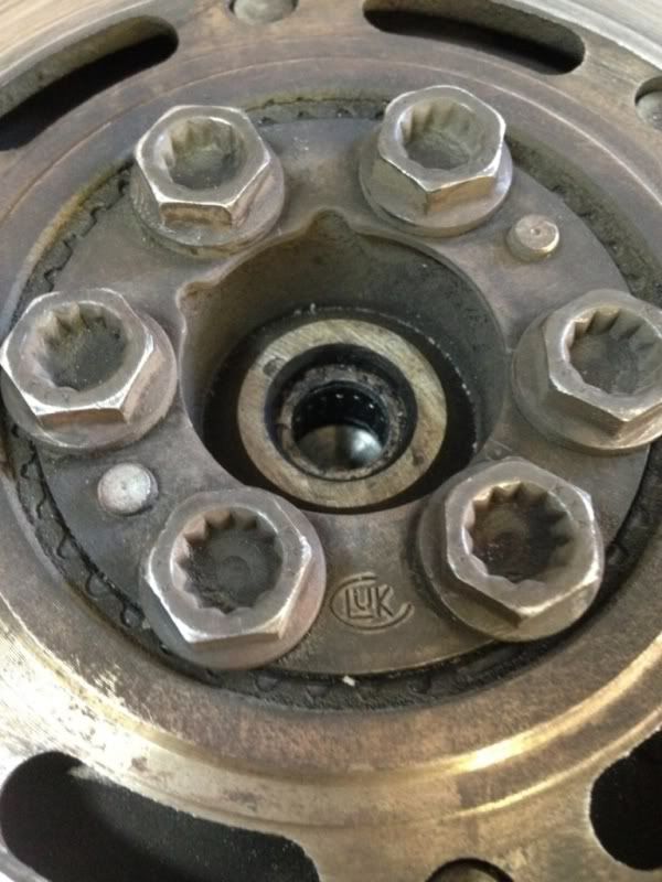

    i have found an AEB flywheel and the guy sent me some photos, there is a pilot bearing in the center do I punch that one out and put the zorkos one in it? I actually thought there wasn't anything supposed to be in there

    Post up a picture. I believe Ive seen some pictures of a stock flywheel that look like it tapered in.

    *I already answered your PM, but I thought I'd post my reply here as well for benefit of the forum readership.
    That flywheel is still bolted to the crank!
    None of that center stuff comes with it. That is the crank snout with the pilot bearing pressed into the crank that you are seeing.
