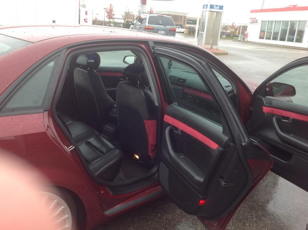

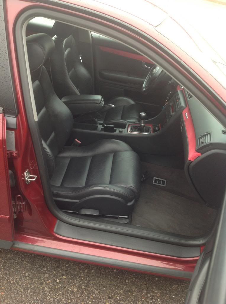

    The pics of the "tabs and rails" in that thread are MK2 TT. The MK1 TT rails are narrower, I had flat steel cut and drilled. Easy to do, here is a pic when I was mocking them up
    Here they are installed. I had to cut a square in the lower plastic so I could retain the comfort light in the rears
    As far as wiring goes, just find someone parting a TT and get the car side of the harness plugs, splice them in, easy. Best mod Ive done to my car so far. Though, oddly, fully manual, and no lumbar, still comfy though
