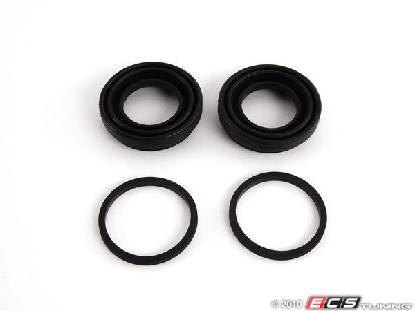

    If you buy the rebuild kit...aren't you technically "remanufacturing" it? LoL
    $8.25...labor is free if you do it yourself.
    http://www.ecstuning.com/Audi-B5_A4-...r/Rear/ES1596/

    those rebulid kits are just seals i just stated how the piston wont move.... so i need a new caliper. any ideas on my parking brake adjuster being stuck?

    The point being after you take them apart, you will clean everything up and put new seals and dust boots on. In effect, your calipers would be brand new

    There is a rebuild kit for $1.58 on rock auto. You are trying to tell me you have enough money to access the internet but don't have enough to buy a $1.58 seal and dust boot and $5 worth of sand paper?
