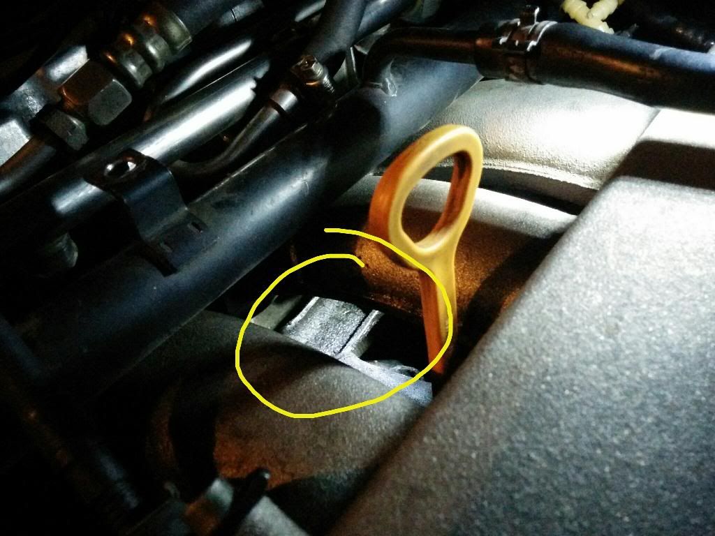

    Please help identify this pipe. PICS.
    B5 A4 1.8tqm AEB: Does anyone know what this pipe is for? It's underneath the intake manifold, looks like it has a big crack. Car drive fine though.

    Time for a catch can and Pcv delete!

    Same pipe blew up on my car too. I got one from ebay for cheaper and its stood up well. Or you could go catch can...

    I knew it! Just didn't know which part it was. Thanks fellas.
