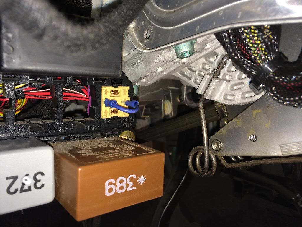

    Yep, could be the alarm. The starter relay requires a ground that is supplied by the transmission being in Park or Neutral (or clutch being pushed down if Manual trans). This ground is required. It also "passes through" the locking module. That way the alarm can deny the starter from operating.
    What you can do is bypass the entire mess. Pull the starter relay out, and put a bypass wire in its place. This connects the START signal from the ignition switch DIRECTLY to the starter solenoid. Pow. It's like that, son. All safeties removed.

    Thanks alot bro im gonna try that
