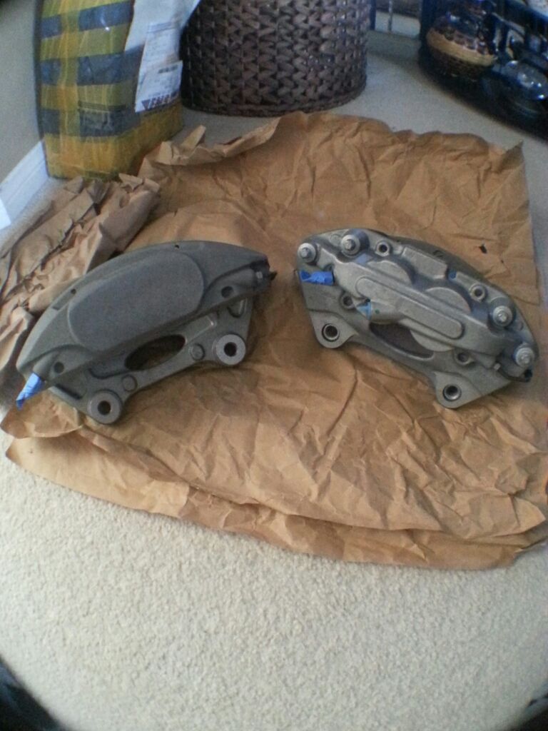

    Had to put off writing my paper because these came in....
    -Thomas

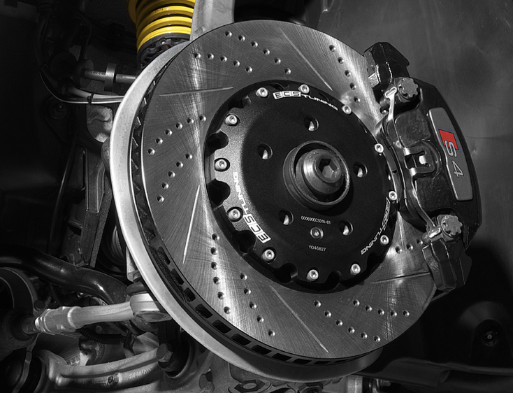

    Inspired by this:
    -Thomas

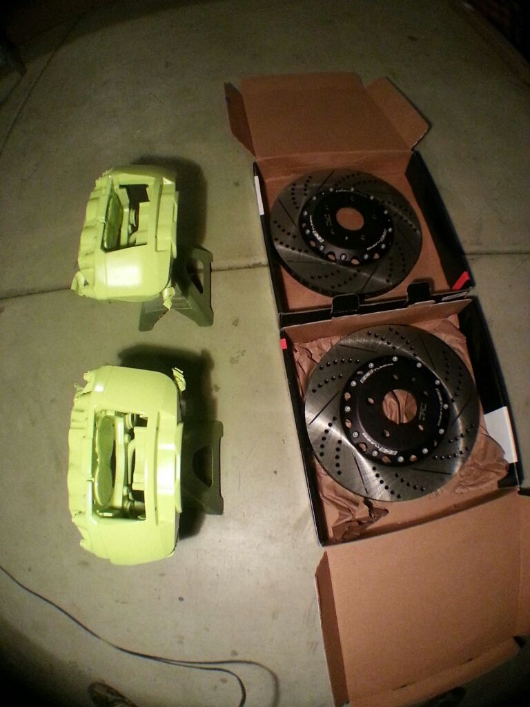

    Sep 14 2006
    11290
    I still have to weigh the calipers, but the rotors are 30% lighter

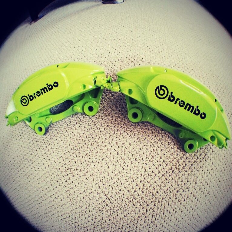

    Calipers weighed in at 9.4 lbs on my bathroom scale....
    Also, stickers are on.
    -Thomas

    Sep 14 2006
    11290
    Quote Originally Posted by audistealth View Post
    G2 caliper paint maybe?
    Hi temp engine primer, then the Rustoleum green paint from home depot, then a hi temp engine clear
