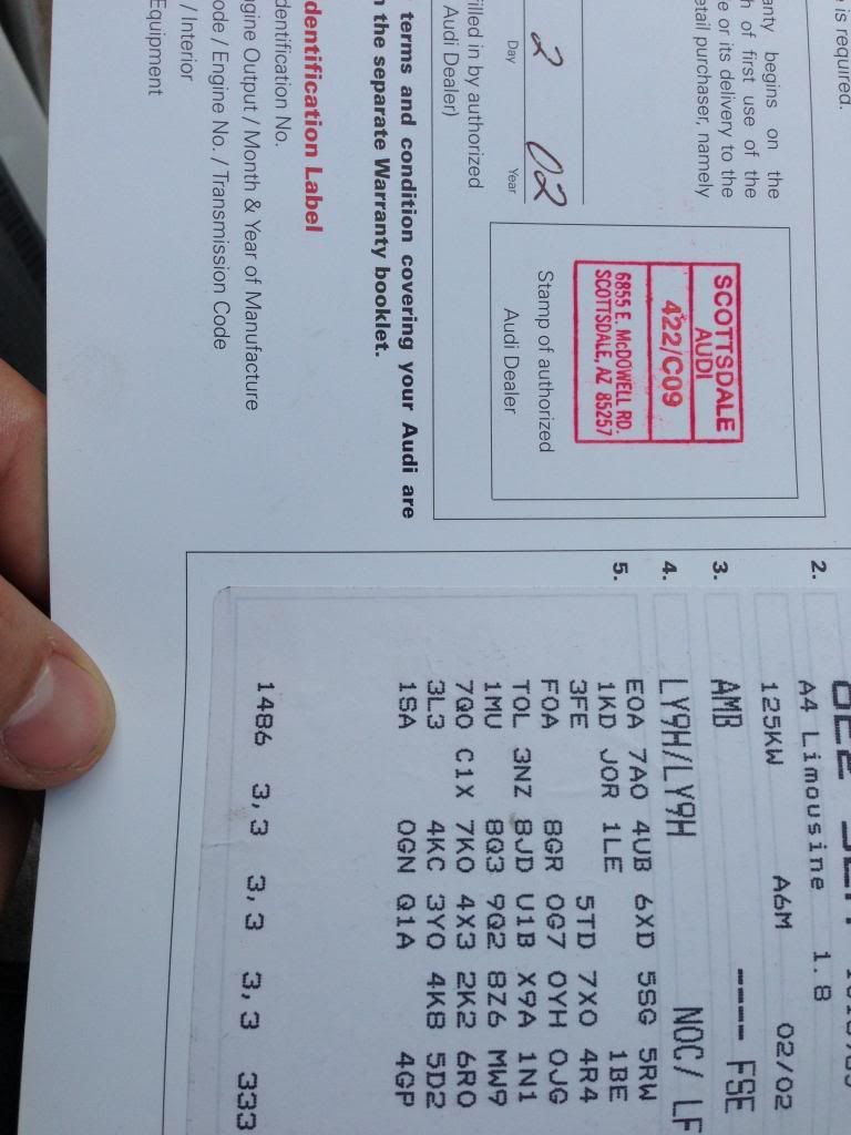

    Interior color code is on the option code sticker in the trunk. It may be a single code (like LE for beige) or it may be 2 codes for a two-tone interior.
    Apr 07 2011
    73592
    You might be able to call the dealership with your VIN to get the interior color. It would save you a trip because there's a good chance they don't have it in stock. There should also be a color code inside your owners manual for the interior. I'm not sure which one it is but it's gotta be there in the front of the book.
    Edit:Walky, didn't even think about the tag in the trunk. It's gotta be there also since the color code of the paint is and that's what led me to believe it's in the owners manual.
    Apr 07 2011
    73592
    OP, in this picture NOC/LF is my interior color code. Yours should be in the same place inside your owners manual or on the trunk tag. LY9H would be the paint code.

    Thanks for the help guys, it looks like my interior is platinum after all. part# 8E0881253AE82
