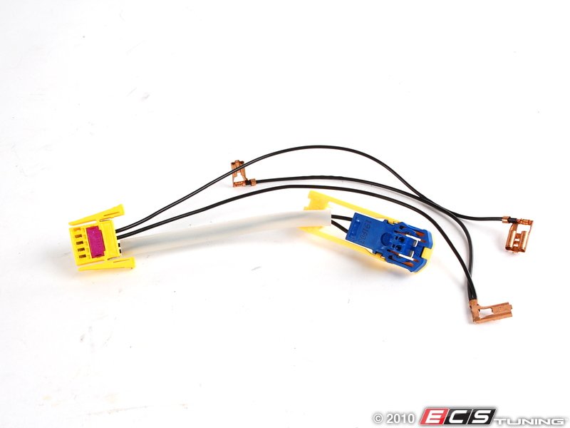

    Ok, I bought the harness and plugged everything in. And my horn doesn't work? Anyone got a picture of there wiring? Don't know if I did the wiring right. I had to cut one of the black wired connectors to install a smaller connector. To connect it to the back of the steering wheel. Here is a picture of my wiring. I installed my old steering wheel and the horn works. Any help would be greatly appreciated.

    Thanks for the picture of your setup Daler08. I have that wire in your picture. I guess I need to re-attach it to the steering wheel. That means I'm going to have one left over black connector on the RS4 connector...Hummm...

    That's the wrong harness you got there, but you can just cut one of the horn wires off.
    The horn wires are the ones right next to the airbag wires.
    The ground wire (the one on your airbag) should be connected to the male pin at 3 O'clock.

    Thanks for this info DolphinV8. My RS4 horn works now.
