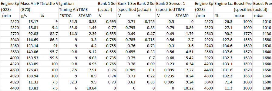

I just replaced an EGT and 02 sensor for Bank 2. Everything is happy now, no codes. was getting misfire etc from shorted wire on 02, and had a code for EGT.
Car runs a lot smoother and more powerful, and boost is back.. except after logging to verify, I get bank 2 actual and requested voltages going quite low.. dumping fuel. No other codes, runs fine.. any one care to hazard a guess?
requested and actual boost steady at 1650 or so
