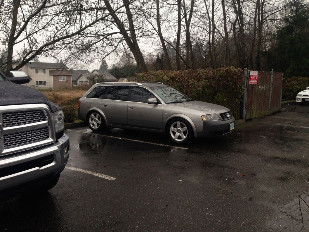

    What happened to your rs4?
    St coils are the most inexpensive.
    Ideally you want to do a6 uprights, top hats, and lca's. When I went static I originally I used all allroad parts but had "clunking", when I switched to a6 parts everything fixed itself. For what it's worth I'm on a6 sport suspension and the car is pretty damn low for an a6 and the ride quality is excellent. Handling is fine, and somewhat sporty with h-sport sway bars. Not pss9 handling, but fine for me.
    -dre
