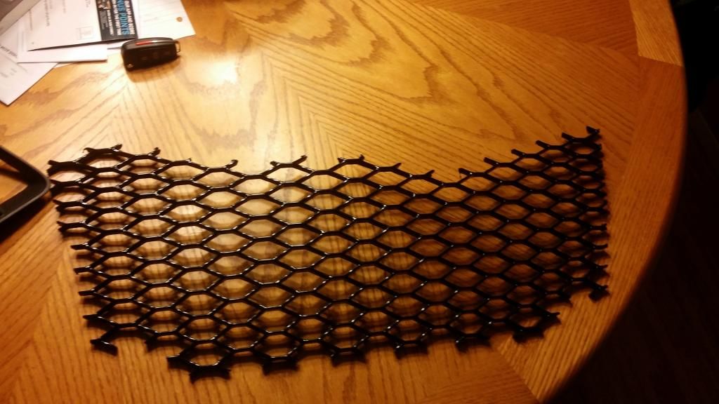

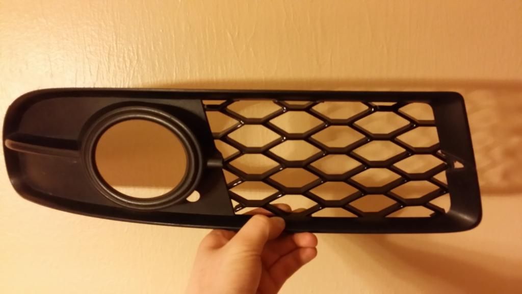

    I just did this 2 weeks ago.
    I wouldnt recommend buying the RS4 fog light grilles. Theres not enough mesh to cover the hole, I cut one up and didnt match up so well and i wasnt pleased.
    So then I bought a cheap mesh grille from Ebay and cut that up and used that mesh.
    100 times easier because you have room for error. On the RS4 grilles you mess up and your really hurting.

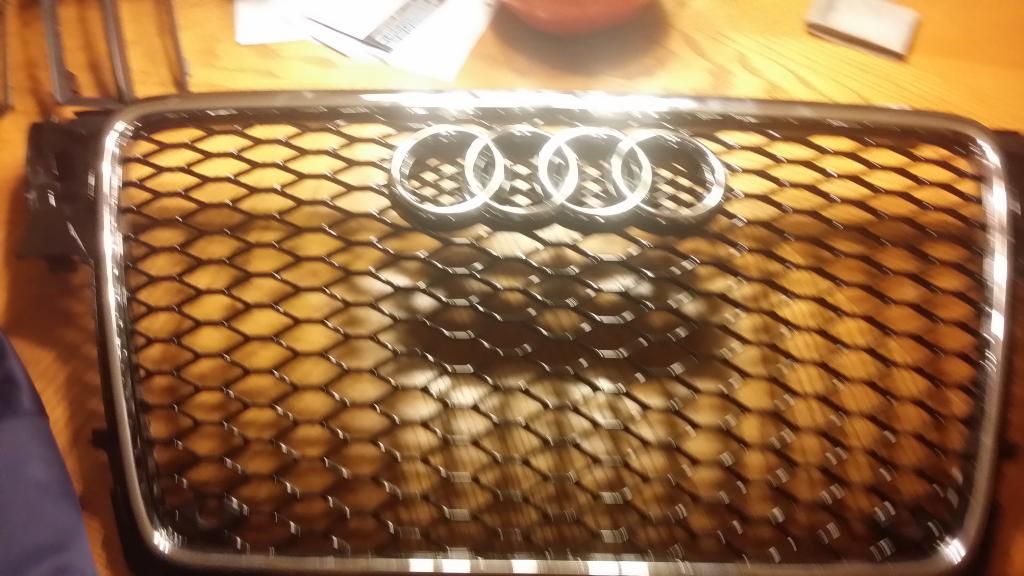

    I bought the mesh grille local for $100 bucks i'll have pic's in a sec
    http://www.ebay.com/itm/RS4-look-Ful...ht_5576wt_1124
    Looks like this one, I'm sure any grille with the same style mesh would work fine

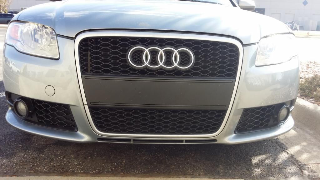

    very nice results!
    Think I'll try and find a similar mesh on ebay and try save a buck.

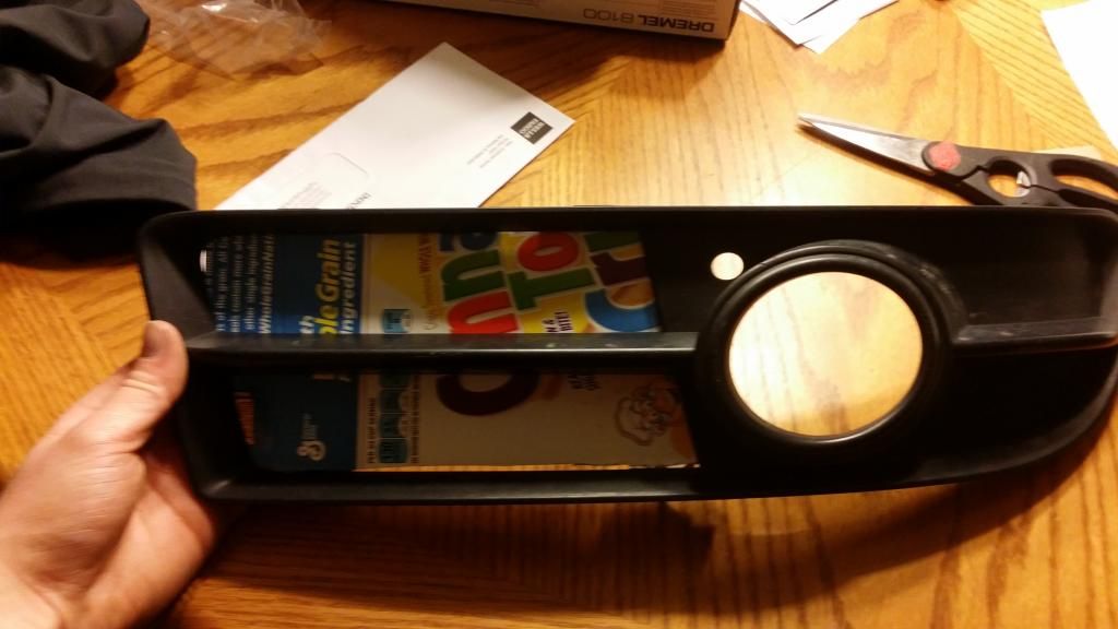

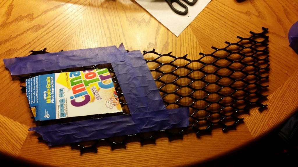

    Thank you!
    Mind you its very tedious work.
    Definitely going to need a dremal

    wow, great work Ax-Rings.
    I did a similar route, no where near as nice as yours... but it was totally free, so I'm not complaining too much. I grabbed some metal mesh from work and just painted it black. I'll have to give your DIY a go, I'm digging that OEM look

    Also when I finished it all I threw a coat of black Plasti dip to get that flat finish same as the center grille
