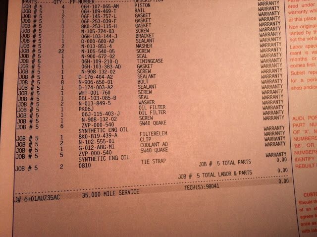

    This is Phase 2 (May involve more depending on what they see when they get in there i.e rods, head, entire short block...):
    [IMG][/IMG]
    [photo from here somewhere]
    Phase 1 is PCV, Crank Seal(s), Harmonic Balancer (sometimes) and some reprogramming and weighing of oil to confirm usage. More or less, differs by case.
