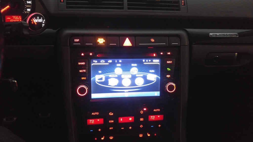

    I just ordered the Witson W2-M050 directly from Witson. They just started selling it a couple days ago. It's appearance is of an updated version of the S100 and they're calling it the S160 model. I'll post an update once it's received and I figure out the install. So far I've only purchased the enfig antenna adapter(Enfig AAA-VWAUD5), but plan to purchase also one of the trunk handle backup cameras I saw posted in a different thread a few days ago. I also plan to disassemble it first thing to look at it's internals to see about upgrading the memory and possibly checking it's internal flash if it's removable and possibly being able to swap it out for faster flash.
    The main specs on it are:
    android 4.4.4
    1.6 GHZ quad core
    1GB ram
    front SD GPS map slot
    front SD slot
    front mini USB
    all the rest of the usual features including can bus steering controls
    Link to new head unit:
    http://www.witson.com/en/displayprod...roID=102507243
  24. #2024
    Veteran Member Four Rings onedumslack's Avatar
    Mar 05 2014
    151526
    phoenix/az/usa
    I received the unit today. To my dismay when I disassembled the unit there was no removable flash or memory chips. Oh well, I was expecting removable modules for these.
    The install was super easy. Just inserted keys, removed symphony, had to solder a couple wires back together that previous owner had cut, then plug the provided harness into the stock harness, plug in the provided GPS, plug in the enfig antenna(which was actually not needed cause the kit came with one), solder the antenna power to the provided harness, then plug the harness into the back of the unit and powered it up.
    I'm still learning the menus but so far it seems to work pretty well. Sound quality is better than stock, the FM/AM reception so far is just as good if not better than stock, the screen quality is decent(certainly not on par with a recent tablet, but for a head unit it looks fine for me). There is something wrong with the provided igo maps app. It does not show the map and says that there is no map for where it says I currently am. I know its a problem with the app cause I started up Google maps and it immediately showed my location and loaded up the map. GPS status also was showing that I was connected to 11 satellites. So I'll be testing out their quality of support next.
    Overall I'm very pleased so far with the head unit. A feature that it comes with that is pretty nice is I pulled into the gas station and went in to grab a drink and when I returned and started the car it immediately started playing the CD right where it left off. No boot delay. If you power back on within 5 minutes of power off there is no boot time.

    Quote Originally Posted by onedumslack View Post
    In the settings for the nav make sure the file name location is pointing to the card slot or wherever the maps are stored. Only solution I can think of or the file is corrupt but I think you'd get an error for that.
    Gonzo
    Congrats on the new unit! Post some pictures please. Few menu shots :) Always nice to see.
    Kristian

    Quote Originally Posted by Copen-cisco View Post
    Thanks. I'll post a few in a couple hours after my drive to work. I think it looks perfect in the bay.
