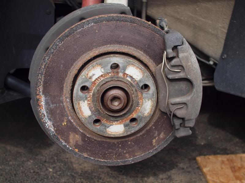

    Before....
    After...
    Total cost: $175
    Brad 2002 Quattro 1.8T w/ 2.8 B5 5-speed
    Veteran Member Four Rings vhstejskal's Avatar
    Feb 01 2011
    70333
    UT
    Quote Originally Posted by DPDISXR4Ti View Post
    Before....
    those looks like they were used as a boat anchor...
    -Vic
    Jul 03 2010
    61005
    1988 Merkur XR4Ti, 1986 911 Coupe, 1991 Alfa Romeo 164
    New York
    Quote Originally Posted by vhstejskal View Post
    12 years of bare iron exposed to the rust-belt elements and it looks like it!

    according to those pictures, theres at least a pound of dirt on them which would be negated given you are going to finish them off nicely with paint, right?
