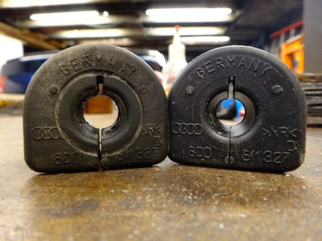

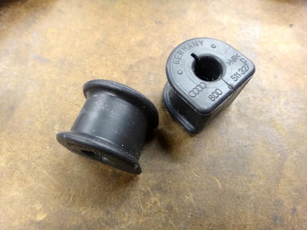

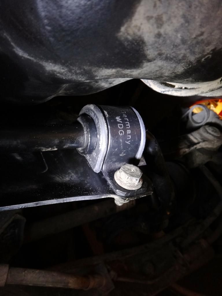

    Not yet, I just put the new rear sway bar bushings in. I'll be going out shortly to get a burger for dinner though.
    The new RSB bushings aren't nearly as flashy as the blue Apikol bushings. My old ones weren't in that bad of shape, but I figured I'd replace them while I was working on the back end of the car.
    Old vs new.
    Installed.

    Upgrade to the 034 rear bar. Makes a huge difference. I run Hotchkis front and rear, but def would have run just the 034 rear if I didn't have any. Picked my Hotchkis up before the price hike and got them for like $430 shipped to my door brand new.
    Veteran Member Four Rings BaseDrifter's Avatar
    May 18 2010
    59183
    I absolutely will be when funds permit. I'm running an S4 rear bar right now which was a big improvement over the stock non-sport bar, but I'm sure the 034 bar is orders of magnitude better (and therefore so is the price.)

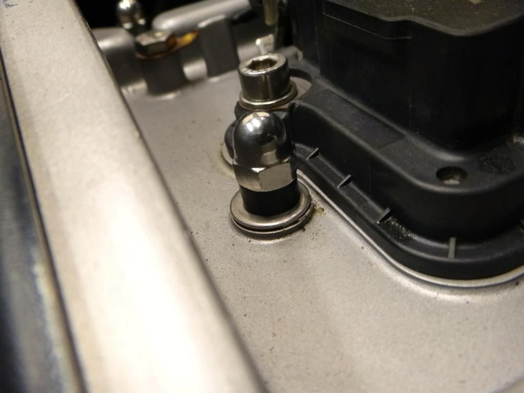

    I raised my idle from 800 to 900 or 1000 because of the SD mounts, what really bothered me was when the A/C compressor kicked on my idle was affected and you could feel the motor bog, and the car would shake. Raising my idle fixed it though.
    My car already shakes at idle when I turn the AC on, probably because of the SD tranny mounts. I've learned to just live with it. I turn my AC on so infrequently that I don't think it's worth raising the idle permanently. When I put the motor mounts in I'm going to make sure to leave everything loose and let all the mounts settle at idle.
    Link doesn't work.
    Quote Originally Posted by ray4624 View Post
    i grew up around 18wheelers and harleys...every nut/bolt etc had a chrome cap.
    there are still a million floating around in my garage that i try to use for random things.
    there is a store in New Hampshire called berube's....its like a candy store for truckers...everything chrome/stainless imaginable...i used to love trips to that place lol

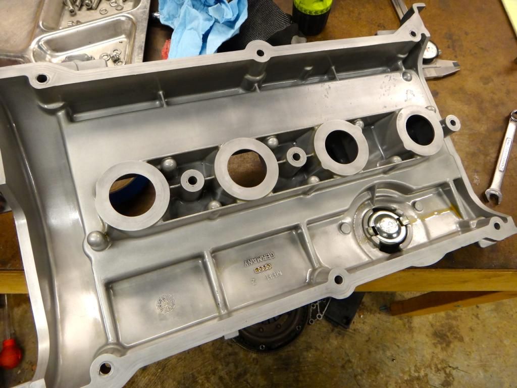

    Nice, Ace Hardware is my go-to store for SS hardware. They always have a nice selection, except for today of course. They only had two acorn nuts in the size I need. Hopefully they get some more in Wednesday otherwise I'll have to shop around, need to get the nuts before the meet on Saturday.

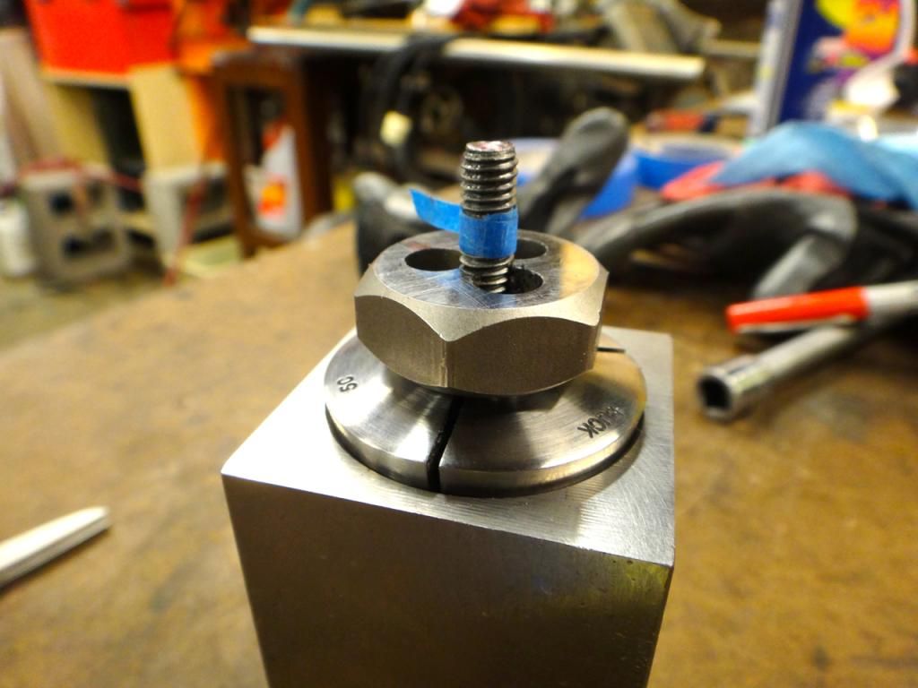

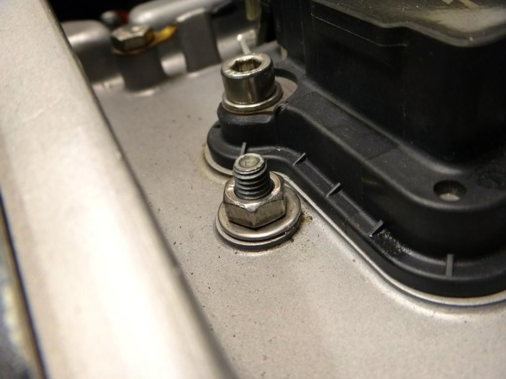

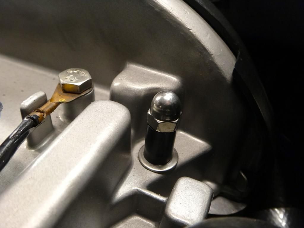

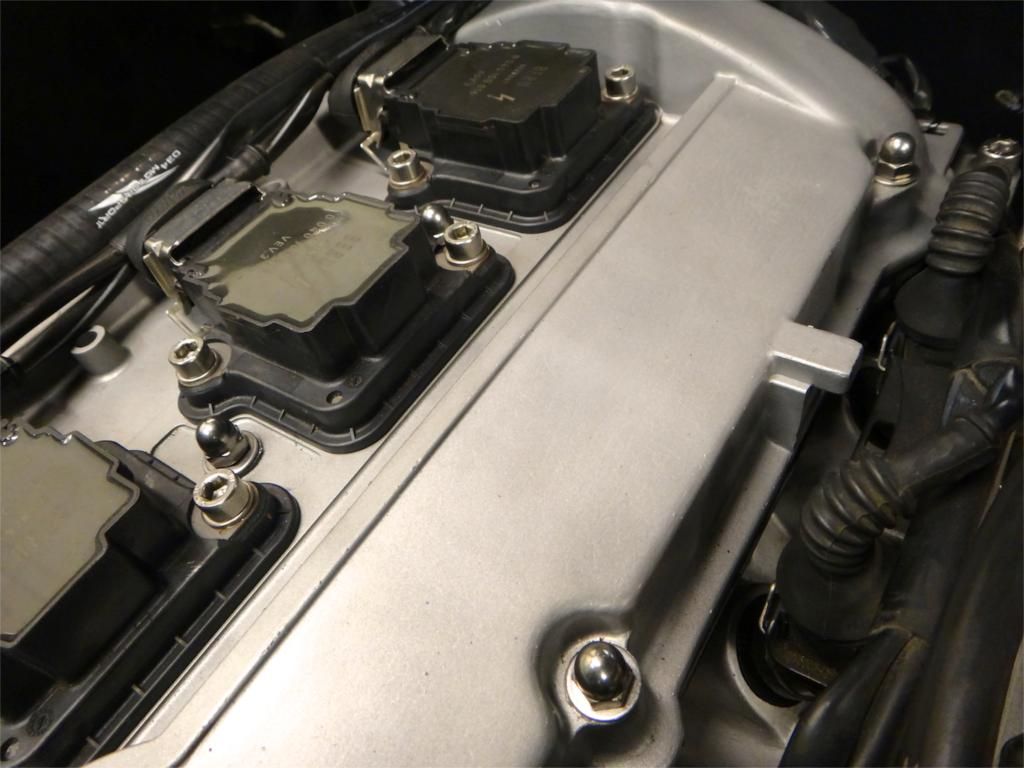

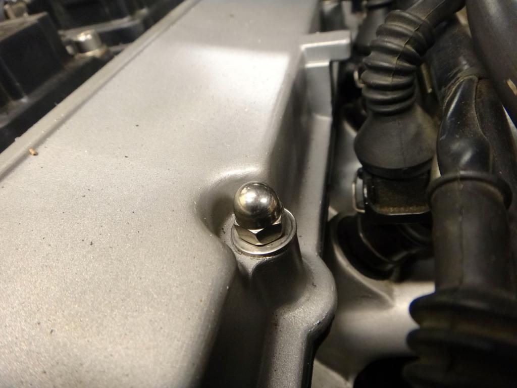

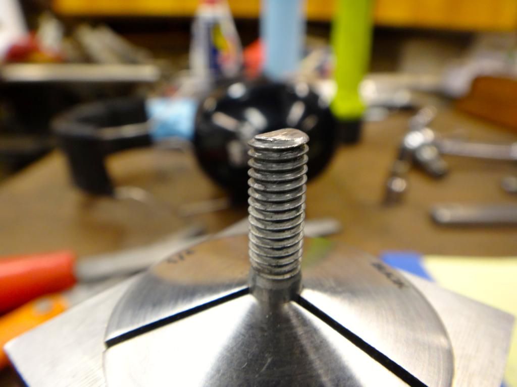

    I have a bit of a dilemma with the acorn nuts though. The whole reason I wanted to use them was to cover up the ugly top of the valve cover stud.
    The problem is that I have three different length studs sticking up from the valve cover. We'll call them short, medium, and long.
    The short ones work perfectly with the acorn nuts.
    The medium and long ones are too long though. So I have two options, I either cut the stud shorter to match the short studs, or I use a spacer of some sort. I picked up a couple black nylon spacers, but I don't really like how it looks. Looks funky. What do y'all think? I don't think it would be too hard to cut the studs and chase them with a die, but that means taking them out of the head and a risk of breaking a stud.
    Medium.
    Long.
    | Update thread / Youtube Channel |
    97 A4 1.8TQM: Frankenturbo|TyrolSport SMIC|034 HFC|Borla catback|Carbonio/007 DV|Vogtland GT3|034 RSB|Apikol Bushings|034 SD motor/tranny/strut mounts|A8 brakes/SS lines|JHM trio|Meyle HD CA/TREs|
    01 S4 2.7T: Stock
    Veteran Member Four Rings bhusted's Avatar
    Sep 11 2011
    81119
    B5 A4 4.2L V8
    Kirkland, WA
    I don't like the spacer at all. Could you remove the studs altogether and use some SS button head bolts instead?
    | B5 4.2L V8 Quattro | Tein S-Tech | O.Z. Ultraleggera 18x8 | Stabila Course 22mm rear swaybar | Agency Power WRX swaybar links | S4 front brakes | A8 rear brakes | FX-R HID projector retrofit | Fog projector retrofit | RS4 Grill |Aero wipers |
    Veteran Member Four Rings RENOxDECEPTION's Avatar
    Nov 04 2012
    103464
    2000 B5 A4 1.8TQM, 2000 B5 A4 1.8TQM
    Reno
    trim the stud with a dremel
    2000 Audi A4 B5 1.8TQM AEB/06A
    1998 Audi A4 B5 4.2QM (Thread)
    2000 Audi A4 B5 1.8TQM K24 Turbo, AEB Wideband
    May 18 2010
    59183
    I'd think that would make lining up the valve cover properly when reinstalling a pain in the butt. I'd rather stick with studs for now. Seems like shortening the studs is going to be my best bet. Anyone have tips on removing the studs? Just throw two nuts on and spin them out right?
    Edit: Not sure I'd have room to get a dremel in there, might be worth a shot though...

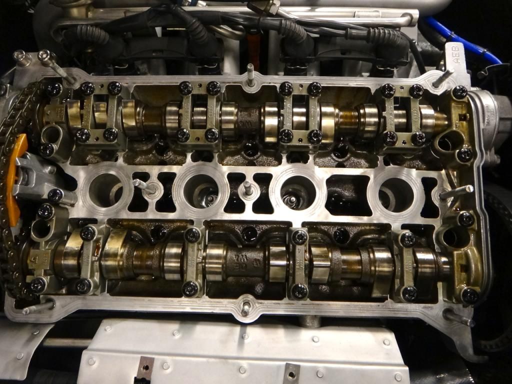

    Thursday night I cut down the valve cover studs to properly fit SS acorn nuts on them. It took a lot longer than I expected, about 4 hours all said and done. If I had to do it again I don't think I would, but it's done now and it looks nice enough.
    I like seeing a nice clean valve cover when it comes off the car.
    My measurements for how much I needed to cut off each stud. I ended up having to cut another 1/16" off the front left stud as the acorn nut bottomed out on that one.
    My setup to cut the studs down. I used a C5 collet block to hold the stud, spun a die down the stud, used tape to mark the cut, and hacked it off with an air grinder cut off wheel. After the cut I spun the die up the stud, filed the edge of the cut and was good to go.
    Cut stud.
    All done.

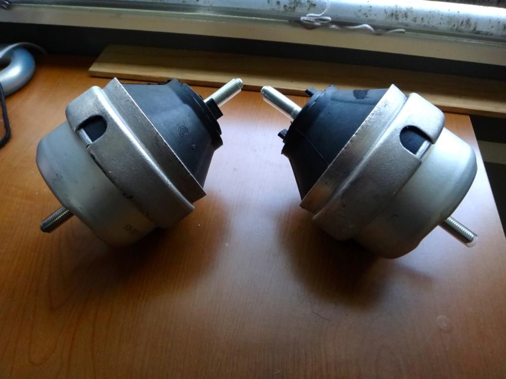

    034 Motorsports Street Density motor mounts arrived today. Might try to get them installed tonight.

    Quote Originally Posted by BaseDrifter View Post
    Should be fun. Are you planning to loosen/remove the nub cage bracket and lifting the engine by the oil pan?
    2001 Corvette (C5) Z06

    I think I'm gonna try removing the brackets first rather than trying to slip the mounts out. Looks like I'd have to lift the engine a good 4-5" to clear the studs on the mounts to slip them out.
    If that doesn't work out, don't be afraid to trim the studs shorter - IMO they really only need to be long enough to fit the nuts. I had my 2001 in service position (turbo replacement), and still trimmed maybe 1/4-1/2" off the top studs. Granted that was using the lift-the-engine technique.

    Lord knows I've got enough experience trimming studs after doing all the valve cover studs to fit the acorn nuts.
    I'll try to follow this DIY.

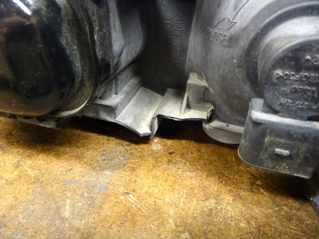

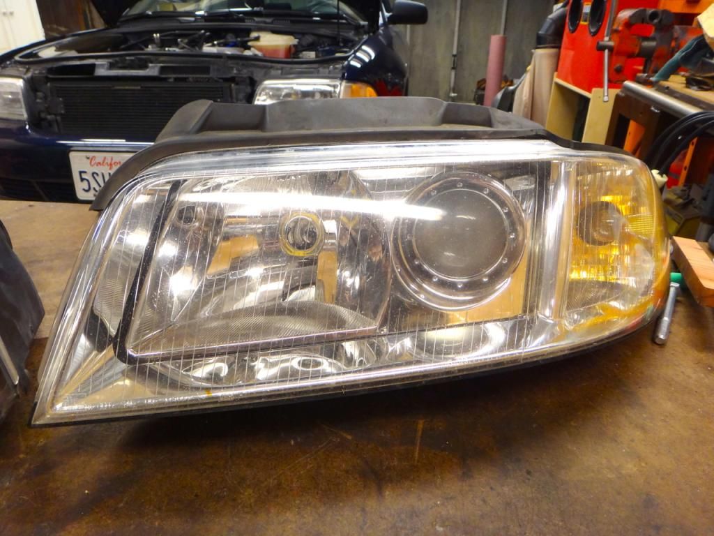

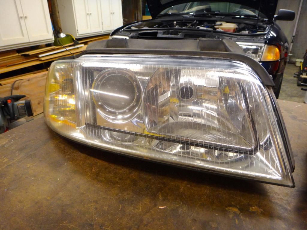

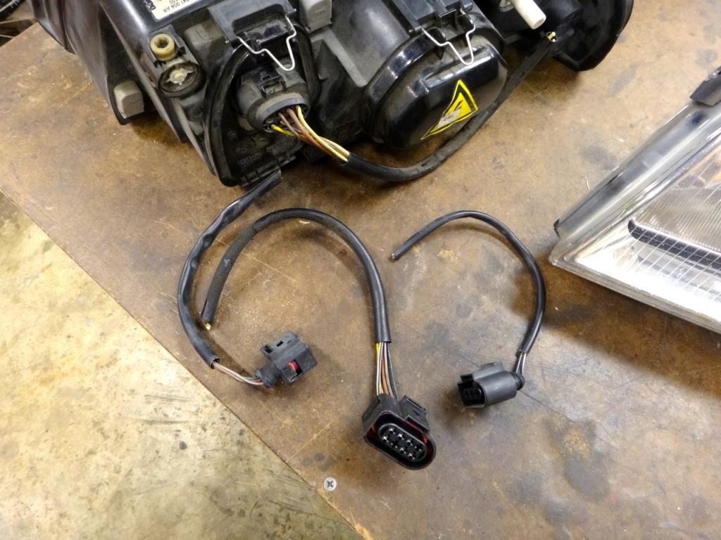

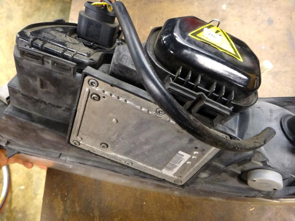

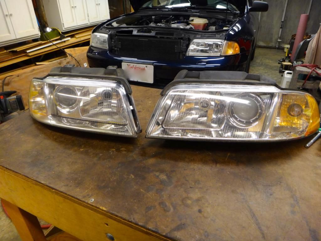

    My brother went to the PnP today to try and find a fender for his car (his B5 got hit and run a couple nights ago), but the car he was looking for was gone. He did however find this set of facelift HID headlights. They seem to be in great condition, except for the fact that the bottom two mounts are broken. All of the upper tabs are there, but the two lower tabs are broken off. I have both heard of this being a problem and not being a problem. I know that I would not be able to utilize the larger mount more towards the back of the light without swapping to a facelift core support, but what about the lower tab that is next to the radiator? I have heard not running any lower mounts can cause the headlights to bounce up and down. I can always try to fab something up to hold them in place as well.

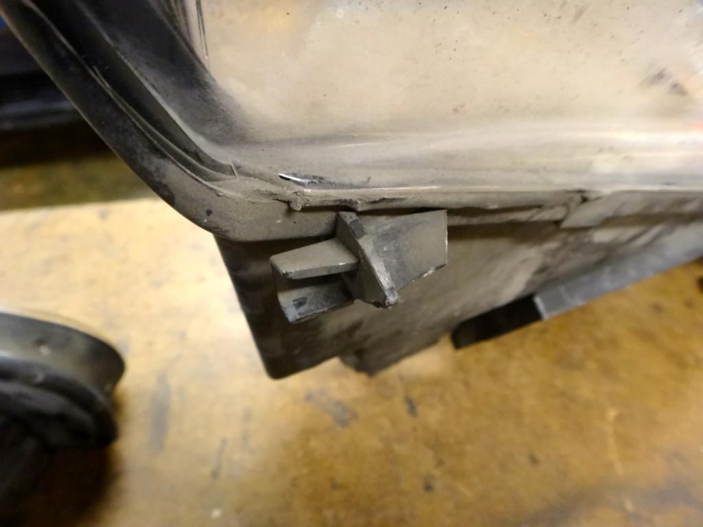

    Another possible issue is that the connector on the headlight side for one of the lights is cracked and no longer a watertight seal. I may see about buying a new connector if I can't find another. He was able to get all four pigtails though, so wiring them up should be pretty painless. Both HID ballasts are there, but I don't know if they work. It's missing the HID bulbs and I will probably have to replace both turn signal bulbs, haven't looked at the high beams yet.
    The price listed on PnP's website is $26 per headlight, but because these lights have the turn signal built in they charged $42 and wouldn't budge. After the environmental fee and tax, they came out to $100 out the door.

    Thanks, this reminds me that I need to hit the local junk yards to find a driver-side head light. It has been given me trouble lately.
    The change from 2-piece headlights to 1-piece headlights is a very subtle touch for early pre-facelift cars. You wouldn't happen to be planning on removing the amber corners would you?

    I think it will be quite a drastic change for the car. New headlights is something I've wanted to do for over 3 years, just never got around to it.
    I will probably end up clear cornering them, but not at first. First step is to just get them installed and working properly. Need bulbs, need to cut the fenders, re-do the wiring, repair a broken connector, possibly fab up a new lower mount. Once all that is done I'd consider clear cornering them and switching to a bi-xenon morimoto projector with clear lens.
    Excellent choice... huge improvement over the projectors that come with the headlights. I even sold off the old xenon projectors to help cover some of the Morimoto Mini cost.

    I would definitely look for a way to secure the headlights since the lower mounts are broken. The pass. side mount on my core support got messed up one time and when I went over bumps I could see the beam of light bounce up and down whereas the other one was solid.
