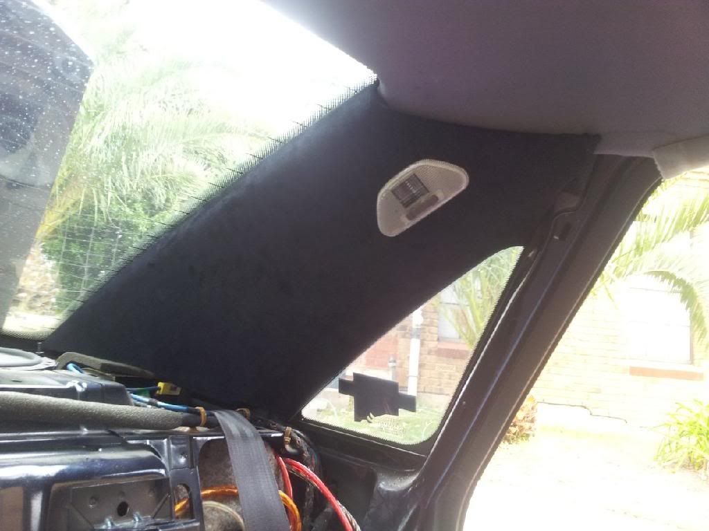

Having just wrapped this pannel i though id share how it attaches and how to remove it, having learnt the hard way myself :p
this is the C Pillar here:

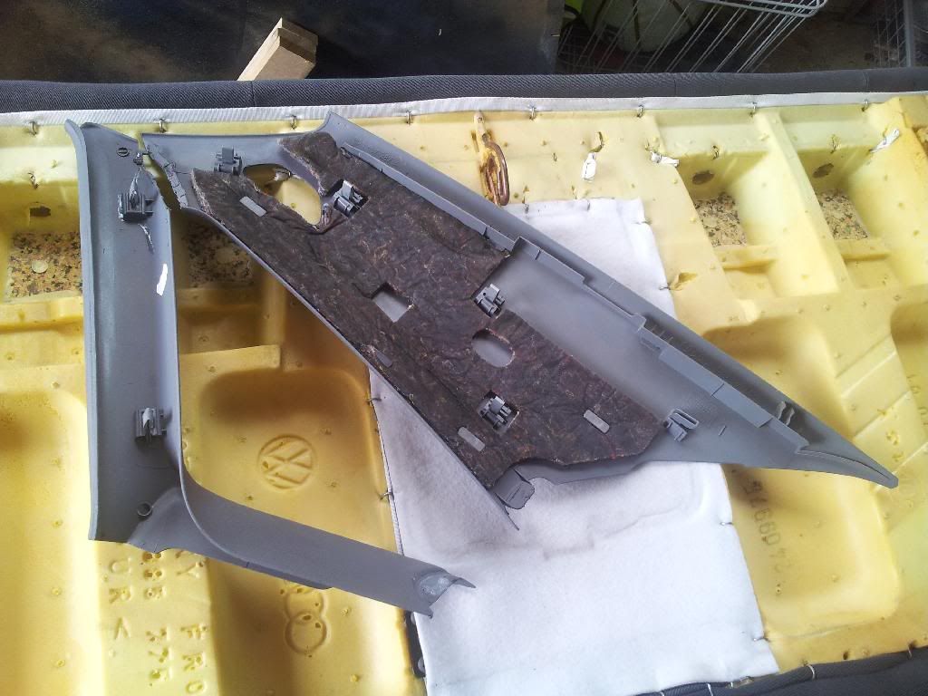

1. To start there is glue in the joins between the two seperate pieces which are shown here:
First, insert the screw driver tip into the crevice at the top and bottom where the pieces meet and give it a good hit to break the glue all around (dont worry, the glue isnt needed for a good fit)

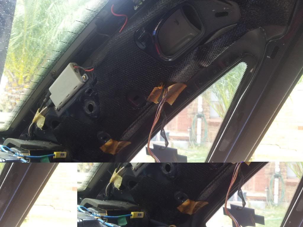

2. after doing this, you can start by pulling on the L shaped trim from the top, inserting the long screwdriver and prying the clips out of the car body. the location of these clips can
3. with this piece removed, you can start working on the larger trim piece, again, pulling it back from the top, inserting the screwdriver between the clips and the cars to remove them. the clips can be seen here:
There with the clips removed, there is a locating leg towards the end of the panel, simply slide the panel towards yourself and it will come free
This image shows the holes and clip locations
