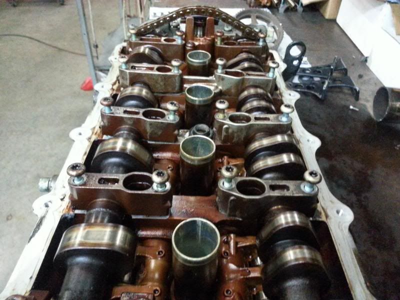

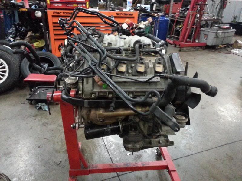

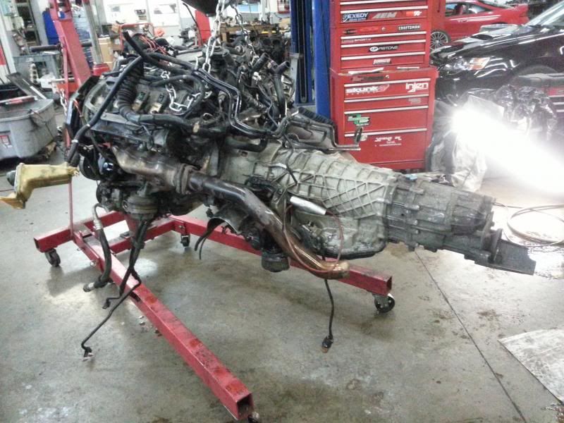

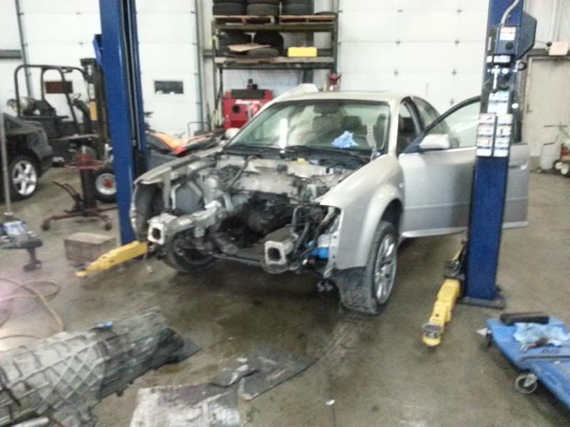

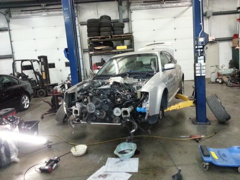

    little update, I removed the motor and trans from the A6, took about 3 hours, which i didnt think was to bad for my first time. Also that motor and auto trans combo is crazy long. haha i sepaerated the motor/trans, and got the motor on a engine stand, cleaned it up and started disassembly.
    removed harness and coolant hoses, intake manifold, and of course both flaps are stuck, i did a leak down test and only got 1% leakage so i am super happy with the motors health. unfortunately both cam chain tensioners are shot, so gonna have to drop money in new ones... i pulled the pan, nice and clean, other than chunks of plastic for tensioner pads that made it to the bottom. i then removed the heads so i can port them and replace valve guides and nice fresh valve job.
    and some pics:

    Wow, that drivetrain is huge.
    How much do the tensioners cost? Can you just replace the guides instead?
    from what im finding, for OEM - not from the dealer is about $1250 for both, ebay knock offs are $350, i cant do just pads, because its worn past the pad into the metal on one, and i dont want one new and one old... so the search is on for a better price....
    I have a set out of a 2.7t (yes, they are interchangable) if you need them. 112k miles, good pads. They came out of a running motor, I logged VVT and verified they are both good.

    Or pick up a set of used 4.2 ones. I would run a decent set of used OEM tensioners over brand new aftermarket ones any day.
