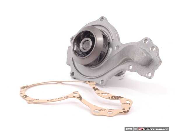

    If you have no coolant flow its pretty obvious the water pump is shot. We have replacements available below!
    Assuming you have an AEB you'll need the pump pictured.
