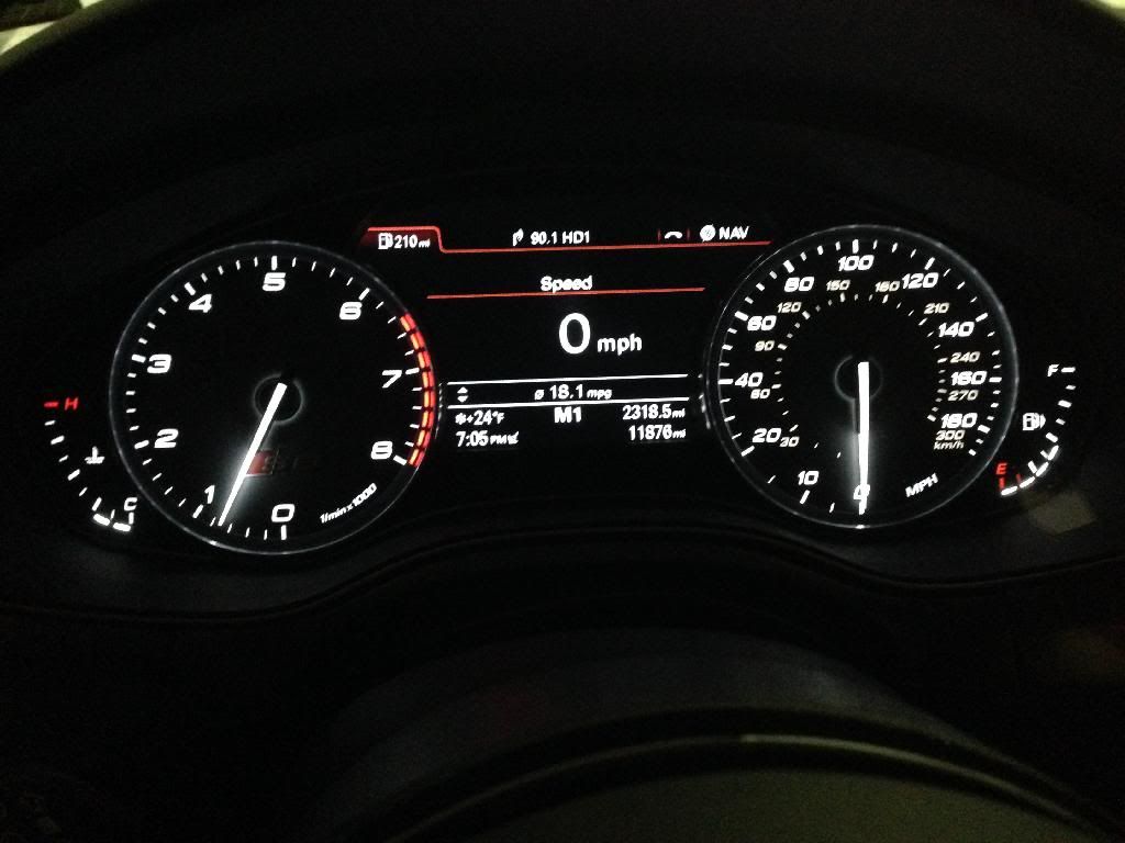

    regarding the needle sweep, is that possible to enable the background led lights inside the speedo counter for 14 rs7. Or is it an European models only mod?
    looks like this

    What is the purpose of the red lights around the speedo?

    When you set your cruise control, one of them will light up to show what it's set to (or two, if it's not an increment of 5 mph/kph).

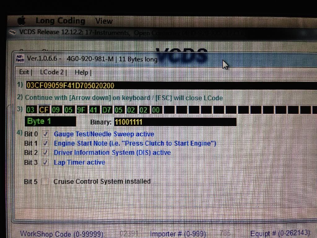

    Hi,
    Any luck enabling these red segments on speedo? I've got 2015MY EUR-spec A7 and successfully turned on the needle sweep, but no red perimeter light (with cruise enabled, too).

    the red segments came with enabling needle sweep on my 2012
    Your car is EUR-spec too, right?
    When you enable cruise control, does it indicate the set speed with a red perimeter segment?
    Yes, and yes :-)
    A friend enabled the needle sweep for me yesterday, no LEDs on my speedo either. Maybe it is a A7 thing, or possible an option package I don't have???
    Oh yeah, why is this thread not a sticky? It is on other model forms, would be great for quick reference!
    Seems like it is a special feature of the cruise control - some cars indicate the set speed with red segments and some don't.
    Would much appreciate if anyone who's car indicates these red segments shares module 17 long coding with me so I will do some research here.
    looks like this
    I've been searching this for a week now. I enabled the needle sweep and only the red lights on the tach light up along the perimeter. Looking through youtube there seem to be versions that do both, just the speedo, or just the tach. Any reason for this?

    The red lights around the speedo are only on models with the Adaptive Cruise Control - they are used to show the set speed when the ACC is enabled.

    After reading through 26 pages of this thread, seems that way unfortunately. Looks rather silly with just half of the lights coming on during the sweep on cars without ACC.

    My 12' A6 does this automatically after enabling the needle sweep
    cool feature
    was your a6 equipped with advanced driving assistance, such as adaptive cruise control?

    Thanks, no unfortunately I don't have the drivers assistance package.

    Sci, thanks for putting this together. It's very helpful. I was able to perform almost all the mods without issue. Successful mods are increase LED brightness, Disable amber corner lights, Disable NAV & Phone warning messages while entering data at speed, Disable Seatbelt Chime, Enable Automatic Gear selection shown in DIS, Enable Hidden menu in MMI, Enable Independent Fogs control with high beams, Enable Remote Operation windows & sunroof
    A couple questions for you guys...
    1) Does lap timer/ boost gauge only work on HUD equipped cars? I was able to access the coding in VAG-COM and check the box for "Lap Timer active" but can not see/ access lap timer/ boost gauge.
    2) when trying to enable VIM and getting the security code, the first digit (#6 in the serial #) is a letter... how do i proceed to enable VIM when only digits are valid inputs?
    -Mike

    Quote Originally Posted by $lick View Post
    Here is how to access laptimer
    As for the serial # never seen that before try using http://www.audienthusiasts.com/Articles_VIM.html
    Driving to dinner I will do more research after.

    thanks Sci, I was able to successfully access lap timer feature
    also was able to enter my serial # in the VIM code generator on the link you posted and it gave me a valid access code to use.

    I enabled both needle sweep and lap timer, but I don't see lap timer

    Quote Originally Posted by yeuchau View Post
    What car what year
    Sent from my SM-G935V using Tapatalk

    12 A6 3.0T
    - - - Updated - - -
    Quote Originally Posted by stingvb View Post
    Lap timer/Boost gauge does not work on some maybe all 2012 models.
    that might be why, thanks
